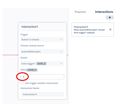

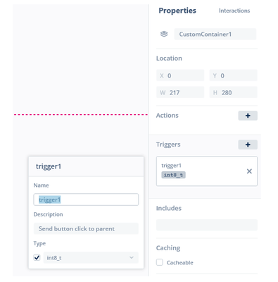

First create trigger to your CustomContainer:
The variable is used for sending the clicked button index.
And then add interaction like this to all three button:
Set value for example 0 - 2 (red circle) for buttons as index.

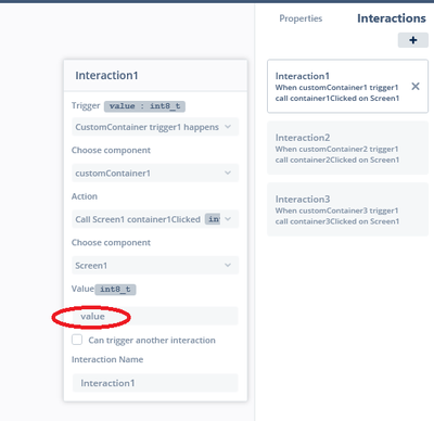

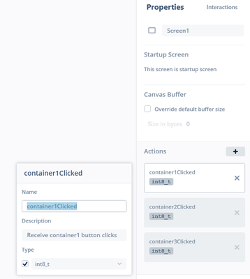

Then in the view, add three action for receiving the callbacks.
Then add three interactions like this
Remember to write red circled 'value' !
Then implement container1/2/3Clicked functions for actions, you can copy prototypes from viewBase.hpp file (if you generate the code after adding actions).

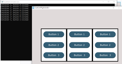

virtual void container3Clicked(int8_t value);Then it works like this

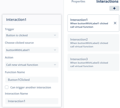

Or like this...manually:
Just set the button interactions to call virtual functions Button1/2/3Clicked at customContainer.

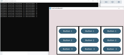

#endif // SCREEN1VIEW_HPPDoes pretty much the same...:
