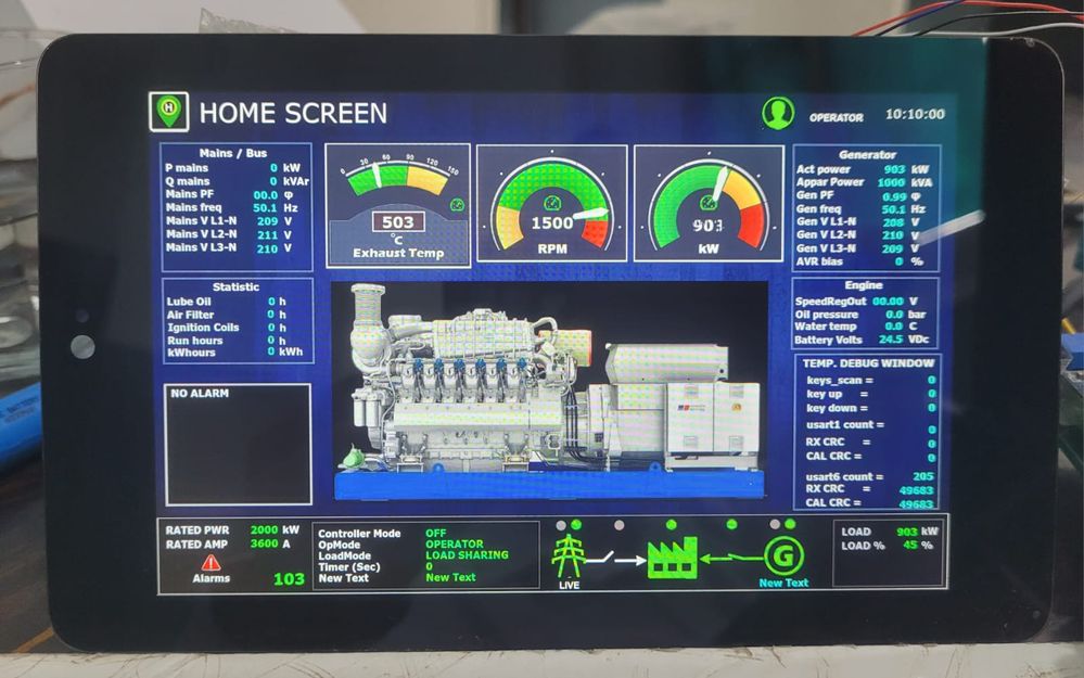

When I first powered the board, the pre-installed demo application on the screen ran correctly.

The original Riverdi application is already available in the demo section of TouchGFX. I also tried flashing that one directly—it uploads the code, but there’s no change on the screen. The display doesn’t turn on.
At first, I thought the screen might be damaged, but it's a brand-new product. I also have two other unused kits, and when I power them on, the default demo runs fine. The kit I'm currently working on also used to show the demo initially, but after I flashed my own application, the screen hasn’t worked since.
