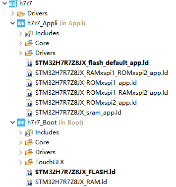

I want to make a project using h7r7 and enable touchgfx,In CUBEIDE,I chose both boot project and application project,but I can not check touchgfx for application project,and it is forcely checked for boot project,can't be changed.Any one knows this problem?is it a bug ?
So,clearly the touchgfx files is generated under Boot Project.
I tried in cubemx,but the same result.

PlacesTouchGFXfolder in h7r7_Boot, as seen in your screenshot

Maybe I misunderstand the meaning of this two project. Correct me if I am wrong :the h7r7_boot means copy code from external flash to ram and run in ram,h7r7_appli means execute code directly in external flash.
Is it correct?
When I posted yesterday,I thought project h7r7_boot is only a bootloader.
