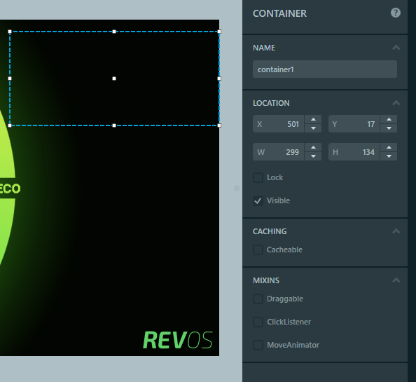

@Michael K Hi, Missed your response. I tried adding text to empty container but in touchgfx I can't find any option to make textArea1 as a child.
2020-12-07 4:45 AM
In the left sidebar with all the screens listed, and all the objects on the screens, just drag the text area item on top of the container item
