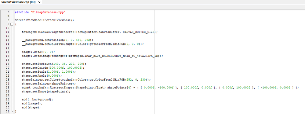

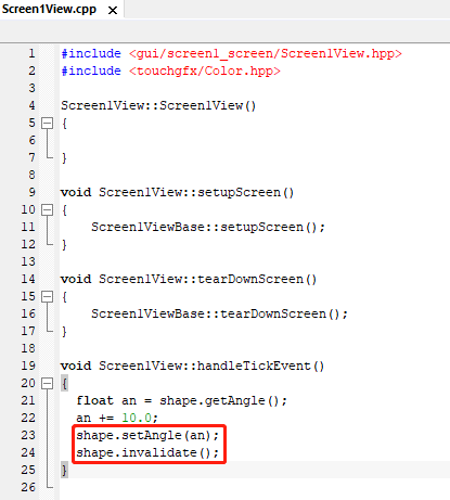

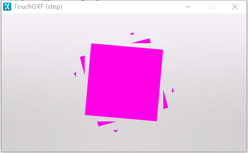

When the shape widget is set to a new angle, it can not completely remove the disability from the previous angle. Is there a Bug or is there another way to solve this problem? Thank you!

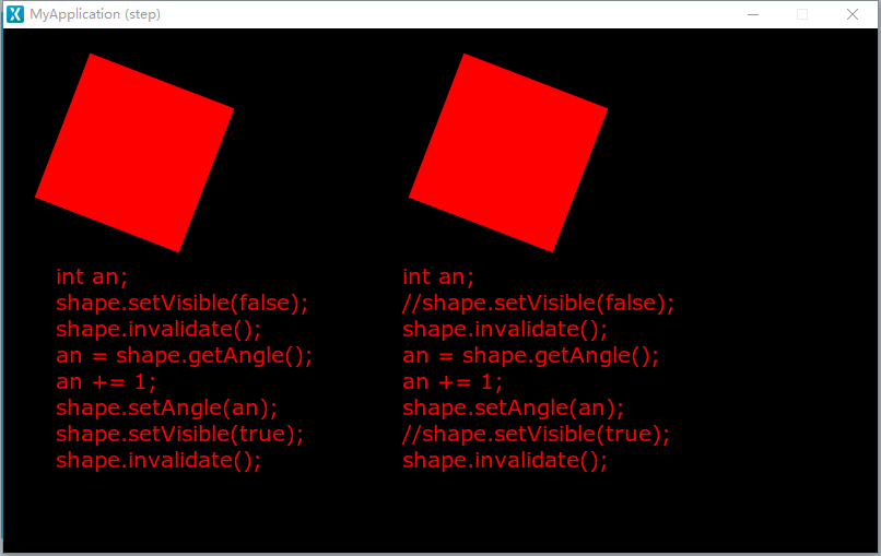

2020-12-06 6:09 PM
Exactly�?thanks, :thumbs_up:
As if the setVisible function could be omitted?
2020-12-07 8:04 AM
when invalidate do job then yes you can omit
