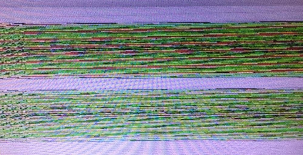

I'm running LTDC at 30Mhz and using the RGB565 format. OCTOSPI works at 120Mhz. It's not clear in the picture. Could it be synchronization disorder or latecy at these frequencies. I am sending the image
2022-12-06 12:18 AM
Again, did you check LTDC status flags?
I'd suggest to copy (largest possible part of) the image from the external RAM to the internal static RAM using very same start address, precisely the same (memory mapped?!) mode via DMA burst transfers and verify that contents in external RAM is correct. DMA burst closely resembles the way LTDC accesses display memory.
