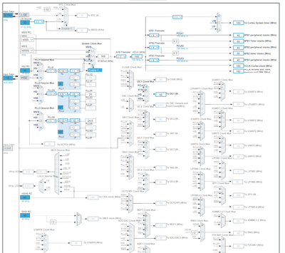

But my display remains a black screen, I then probed PD3 (LTDC_CLK) where I expected the 25Mhz clock signal that was configured, but saw nothing.
I also tried switching the pins "Max output speed" to Very High as I saw somewhere that this was required.
I then switched PD3 to GPIO_Output and toggled it to make sure connections are correct.
Is there something wrong with my clock setup? I tried a test of toggling a pin in the while loop with a 1ms delay and the scope says a full cycle took 4ms instead of the expected 2ms... but then I set the delay to 10ms and eveything is as expected on the scope.

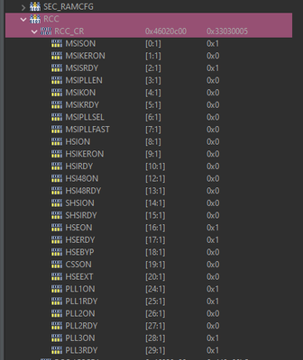

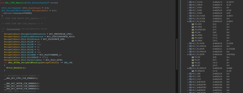

Ah sorry I flipped to PLL3 when experimenting stuff, the code does now also point to PLL3.
Does this look like the PLL3 registers aren't reflecting what the code says?
void HAL_LTDC_MspInit(LTDC_HandleTypeDef* hltdc)
RCC_PeriphCLKInitTypeDef PeriphClkInit = {0};
if(hltdc->Instance==LTDC)
/* USER CODE BEGIN LTDC_MspInit 0 */
/* USER CODE END LTDC_MspInit 0 */
/** Initializes the peripherals clock
PeriphClkInit.PeriphClockSelection = RCC_PERIPHCLK_LTDC;
PeriphClkInit.LtdcClockSelection = RCC_LTDCCLKSOURCE_PLL3;
PeriphClkInit.PLL3.PLL3Source = RCC_PLLSOURCE_HSE;
PeriphClkInit.PLL3.PLL3M = 1;
PeriphClkInit.PLL3.PLL3N = 15;
PeriphClkInit.PLL3.PLL3P = 2;
PeriphClkInit.PLL3.PLL3Q = 2;
PeriphClkInit.PLL3.PLL3R = 10;
PeriphClkInit.PLL3.PLL3RGE = RCC_PLLVCIRANGE_1;
PeriphClkInit.PLL3.PLL3FRACN = 3072;
PeriphClkInit.PLL3.PLL3ClockOut = RCC_PLL3_DIVR;

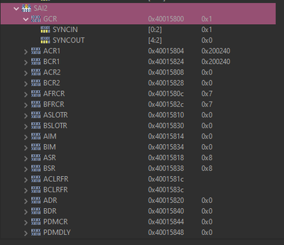

I just tried SAI2 peripheral as it is also on APB2, and it can write to its config registers fine.
I can also write to them and read them fine, so something specific to LTDC.
All the documentation I can find just points to LTDCEN being enabled before writing and nothing else, I'm really at a loss here.

@STOne-32 is it possible this could have been fused like the U5A5 with the LTDC disabled? All peripheral registers are presenting as stuck-at-zero
@PhilipC can you provide a clear picture of the top markings of the IC you mounted.

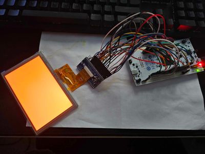

So I went to take a photo and couldn't believe my eyes...
I must have got the chips swapped at somepoint after removing the A5.
I have now swapped the A9 on and sure enough getting all the registers and a LTDC_CLK.
Thank you for your input and sorry for the confusion.
The display is now cycling through Black, White, Red, Green, Blue even though I have an empty while(1) but atleast it's a new problem.
