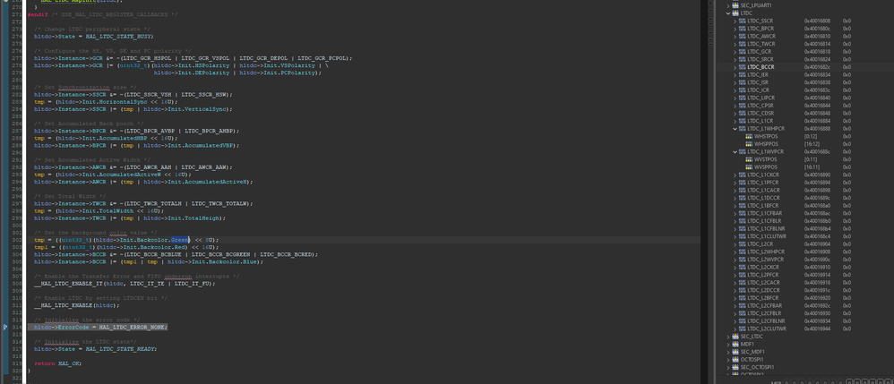

2024-01-19 12:35 PM - edited 2024-01-19 12:37 PM
I observed the registers as i stepped through the HAL_LTDC_Init() and none of the LTDC registers are being updated, so LTDC is never setup nor enabled as they aren't being written to... what could cause this?
The init vars do have the cubemx values in them

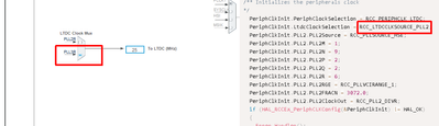

RCC_PeriphCLKInitTypeDef PeriphClkInit = {0};
if(hltdc->Instance==LTDC)
/* USER CODE BEGIN LTDC_MspInit 0 */
/* USER CODE END LTDC_MspInit 0 */
/** Initializes the peripherals clock
PeriphClkInit.PeriphClockSelection = RCC_PERIPHCLK_LTDC;
PeriphClkInit.LtdcClockSelection = RCC_LTDCCLKSOURCE_PLL2;
PeriphClkInit.PLL2.PLL2Source = RCC_PLLSOURCE_HSE;
PeriphClkInit.PLL2.PLL2M = 1;
PeriphClkInit.PLL2.PLL2N = 9;
PeriphClkInit.PLL2.PLL2P = 2;
PeriphClkInit.PLL2.PLL2Q = 2;
PeriphClkInit.PLL2.PLL2R = 6;
PeriphClkInit.PLL2.PLL2RGE = RCC_PLLVCIRANGE_1;
PeriphClkInit.PLL2.PLL2FRACN = 3072.0;
PeriphClkInit.PLL2.PLL2ClockOut = RCC_PLL2_DIVR;
Error_Handler();

2024-01-20 3:02 AM - edited 2024-01-20 4:33 AM
I tried the following and LTDC register will not accept anything.
LTDCRST = 0
LTDCEN = 1
while (1)
/* USER CODE END WHILE */
temp = LTDC->GCR;
LTDC->GCR = 1;
/* USER CODE BEGIN 3 */
/* USER CODE END 3 */
Could it be something with my clock setup?
I added an I2C peripherial and after MX_I2C1_Init() i can see values in the I2C registers, but nothing for LTDC...

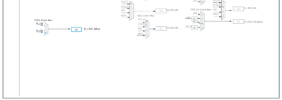

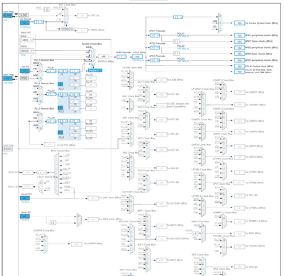

2024-01-20 12:35 PM
So, which one is it, PLL2 or PLL3?
Read out and check/post relevant RCC registers content.
