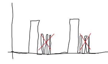

I have to measure the pulse width and the period of Fiber-Optical Signal with STM32F469 Discovery board and view the values on the display using TouchGFX Design.
I have no problem to blocking the display for a while (max. 2s) to read a pulse width that maybe between (1us - 1000us) and the period (10 - 100ms) but i should also ignore some pulses (for data transfer) which they comming within 10ms..
I am using Input capture mode on the input pin and thought to call HAL_GetTick which returns microseconds value of InitTick to be able to ignoring some pulses and to make a global timer then i know where i am but i think all the interrupts will be suspended when the IC called even that for GetTick!
Hier is the signal that i should handle.

With the values you specified, i think, its impossible.
To capture pulses with a timer is not so difficult, thats not the big problem, but to "sync" to the unknown signal, seem impossible : the puls-pause can be 10..100ms , but the "ignore time" is also 10ms , and next pulse can be 0,001ms - so i see no way, to find a good "sync" to differentiate "main sync" puls and any pulses that can be there.
So there should be a clear window: first pulse raising to last possible "any pulse" is 11ms , then a gap of minimum 4ms without any pulse ; so it should be possible, to get this "minimum 4 ms no pulse" gap, to find reliable the next "main sync pulse".

Your image show two amplitude signal ... idea detect it as logical signal is ...

@AScha.3 I have seen the signal on the oscilloscope and it seems infinity pulses (like the photo above) ..
First pulse is (1us.. 1ms that muss be catching and displayed after that comes some noisy pulses for max. 10ms that should be ignored and after that comes the second real pulse regulary with the same procedure, the period of the signal is 10ms ... 100ms.
