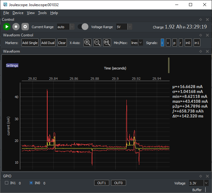

For reference, here is a plot with two scans of the touch controller during MONITOR mode while the STM32 is in Stop mode.
