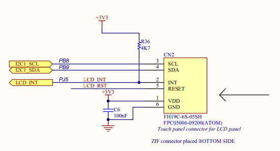

I also found the LCD_INT pin on the schematic: (by the way, why schematics for this board are not on the official datasheet from ST? I found them on userwiki manual website.
I guess you meant PJ5 GPIO.
Let me sum up, so the idea is so to set the LCD_INT as an external Event, falling edge trigger. With this config, even if LCD is sleeping, and LCD display is off, it will still trigger and wakeup from stop mode?
I still don't get how anyone can find that LCD_INT is the pin that is lowered when user touch screen? The LCD_INT occurs 0 time on LCD datasheet neither on Reference Manual.

The touchscreen is always powered on the DISCO board. You can easily monitor the LCD_INT signal with an O-scope at R36 on the connector side while interacting with the touchscreen to see its behavior. If you want to learn more about the touchscreen controller, download the datasheet for the FT6x06 series of touch controllers here.
The entire schematic and Altium board layout for the DISCO board can be found on ST's web site. If I recall, you have to find the STM32F469i-DISCO and it should be one of the documentation items you can download.
LCD_INT is just ST's net name for the signal, so you would not find it on a datasheet, and the touch panel is not a part of the LCD, it is a separate component that gets attached.
