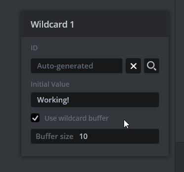

When you have a textArea with a wildcard, that wildcard is a variable stored in memory and I think that setWildcard is just use to change the variable that refers to what you want to print (that is why you have to pass the address of UnicodeChar to setWildcard).
To actually change the wildcard, then you also have to use snprintf.
You also have to make sure that that new buffer assigned to your wildcard is not been erased otherwise, the data it contains (the one you want to display) is also gone.
I would still recommend you to use the wildcard buffer from TouchGFX Designer:
and then using snprintf to change that generated buffer.
So can you please try to use snprintf and tell me if this solves your issue?
