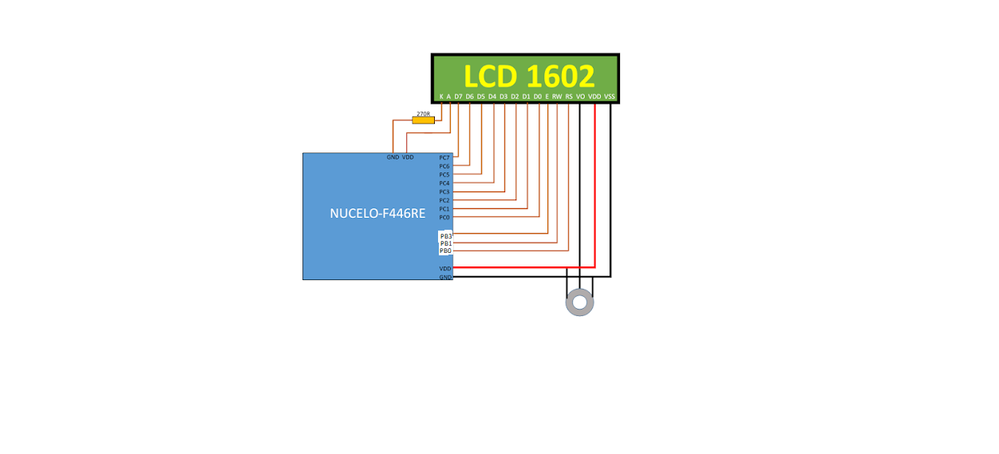

I am interfacing LCD module in 8bit mode to STM32F446RE Nucleo board the connections are as below:
The pin connections(if unclear in diagram):
Control pins:
RS-->PB0
RW-->PB1
E-->PB3
8bit data pins LCD:
D0-D7-->PC0-PC7

@dk.2 "pin connections(if unclear in diagram)"
Yes, the diagram is unclear - please post a better (higher resolution and/or bigger) one.
Are you sure that none of those connections clashes with anything on the Nucleo board?
2022-04-26 9:33 AM
Dear Andrew,
I am sorry for the inconvenience..
I am using Nucleo board only for the LCD program now and nothing else is connected to the board..
I would have drawn the Image Instead I will mention the pinouts here
The exact pin connections are as follows:
LCD--->STM(nucleo)pins
VSS--->GND
VCC--->5V(arduino connector CN6)
VEE---->middle pin of pot of 10k & it's powered with 5V
RS------->PB0
RW------->PB1
E---------->PB3
DB0------->PC0
DB1-------->PC1
DB7---------->PC7
LED+-------->5V
LED- --------->330ohms resistor in series and connected to GND.
2022-04-26 11:05 AM
@dk.2 "I am using Nucleo board only for the LCD program now and nothing else is connected to the board"
I meant, are you sure that there's nothing internal - on the Nucleo board itself - to interfere with your LCD connections?

Look at the board schematic:
https://www.st.com/en/evaluation-tools/nucleo-f446re.html#cad-resources
https://www.st.com/en/evaluation-tools/nucleo-f446re.html#documentation
2022-04-28 8:08 AM
Hi Andrew,
I checked the schematic..except for pin PA2,PA3 which are connected to ST-link circuitry I don't find any issue in using PC0-PC6 pins for LCD. Can you please verify if I have got it right. I checked the schematic in above links.
