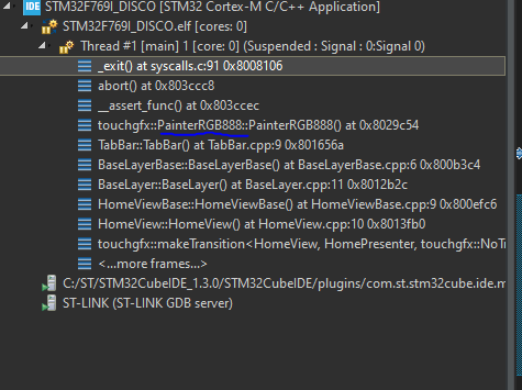

I followed this guide to changing the pixel format of an application. Although my TouchGFX designer file does not have the code listed above the framebuffer pixel format table 2/3 of the way down the page, in the Designer itself it reports 16bit color and RGB565. However, when I build and run my application, the screen appears corrupted and then freezes. The stack trace is attached, but it appears that during the constructor call of one of my custom containers, a PainterRGB888 reference is called and an assertion fails(?), hanging the program.

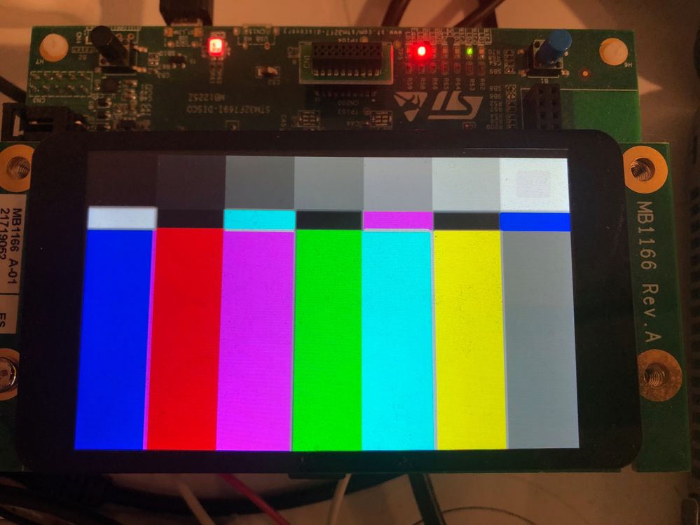

If I make a simple screen that doesn't have that custom container, the display still corrupts though it doesn't seem to crash.

It's not a hardware constraint - In fact, most of the Application templates should have been updated to default to 16bpp instead of 24. The reason why the templates only support a single color depth now is that we're using CubeMX/Generator to create them.
There must be a correlation between the hardware configuration and the TouchGFX configuration, or you'll either get asserts or see weird things. Did you check the support site for a guide on changing color depth? If you can't find it i'll help.

One function I think it still needs to be modified: HAL_DSI_EndOfRefreshCallback() to support 16BPP.

What I can think of - in HAL_DSI_EndOfRefreshCallback() change:
LTDC_LAYER(&hltdc, 0)->CFBAR = ((uint32_t)currFbBase) + 448 * 3;
LTDC_LAYER(&hltdc, 0)->CFBLR = ((832 * 3) << 16) | ((REAL_WIDTH) * 3 + 3);
LTDC_LAYER(&hltdc, 0)->CFBLR = (((832 * 3) << 16) | ((WIDTH * 3) + 3));
by
LTDC_LAYER(&hltdc, 0)->CFBAR = ((uint32_t)currFbBase) + 448 * 2;
LTDC_LAYER(&hltdc, 0)->CFBLR = ((832 * 2) << 16) | ((REAL_WIDTH) * 2 + 3);
LTDC_LAYER(&hltdc, 0)->CFBLR = (((832 * 2) << 16) | ((WIDTH * 2) + 3));
3 for 3 bytes (24BPP) needs to be changed to 2 for 2 bytes (16BPP)
2020-06-16 5:06 PM
Here is the procedure:
OTM8009A_Init(OTM8009A_FORMAT_RBG888, LCD_ORIENTATION_LANDSCAPE);
by
OTM8009A_Init(OTM8009A_FORMAT_RBG565, LCD_ORIENTATION_LANDSCAPE);

In addition, I was using a Painter888RGB in one of my customer containers, which was the actual root cause of the particular assertion failure shown in the stack trace in the OP. Replacing it with a Painter565RGB resolved that particular issue.
