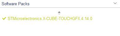

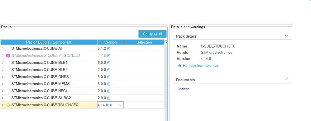

2020-08-28 5:07 AM
Okay so i found another problem. My CUBEIDE AND CUBEMX was working on version 4.14 and updated itself from 4.13 automatically but the TouchGFX designer app remain in v4.13 Should i delete the app and download the latest version again?
