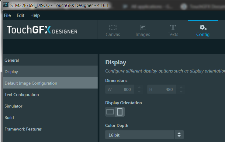

I am having this problem on my custom board, but was able to recreate it with the STM32F769I Discovery Kit template and simulate it. It is an 800x480 display, and I have selected Portrait Display Orientation (the opposite of the native orientation of the display):

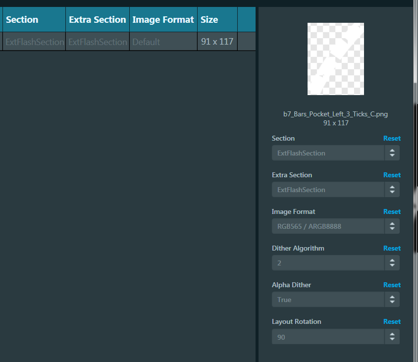

I added an image which will be painted in a circle. Here is the image's settings in the Image Format tab of the Designer:

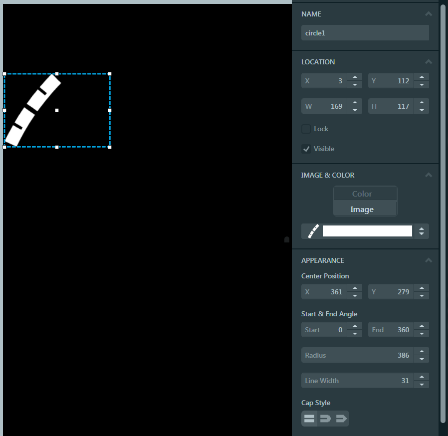

I placed this in a circle. Here is the Designer circle's parameters:

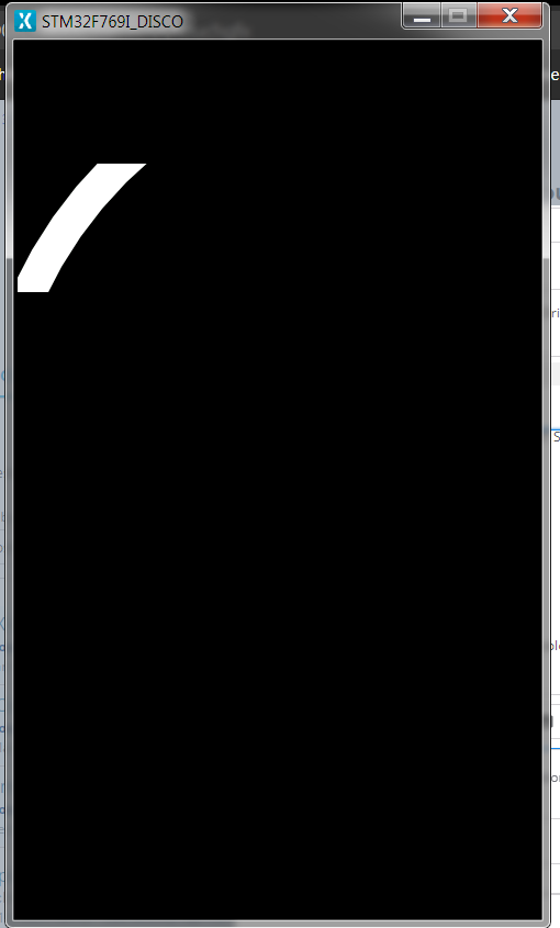

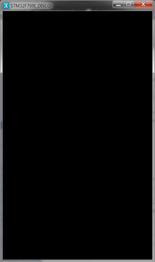

It shows up in the Designer (above), but DOES NOT SHOW UP in the simulator:

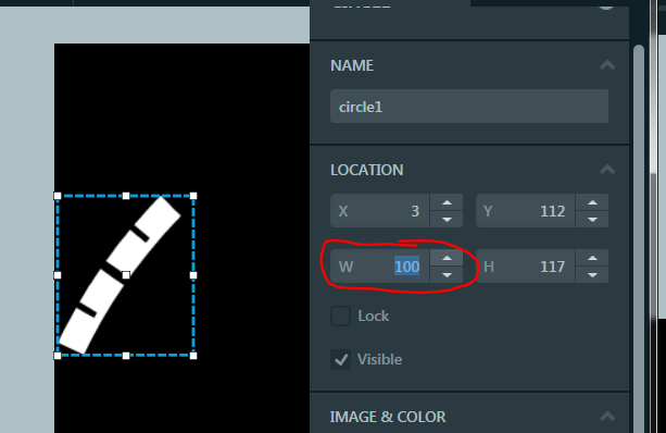

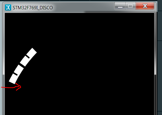

The only way that i have been able to get the image to show up on the simulator is adjusting the width of the circle in the Designer:
It then shows up on the simulator:
But notice also that the image is NOT in the correct location (slightly to the right horizontally).

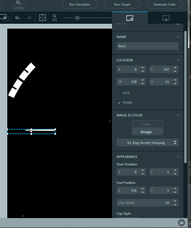

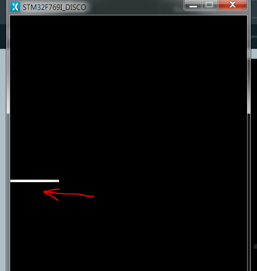

I also found the issue reveals itself when painting an image into a line. I added an image to be painted a line widget in the Designer:
The simulator shows it shifted:

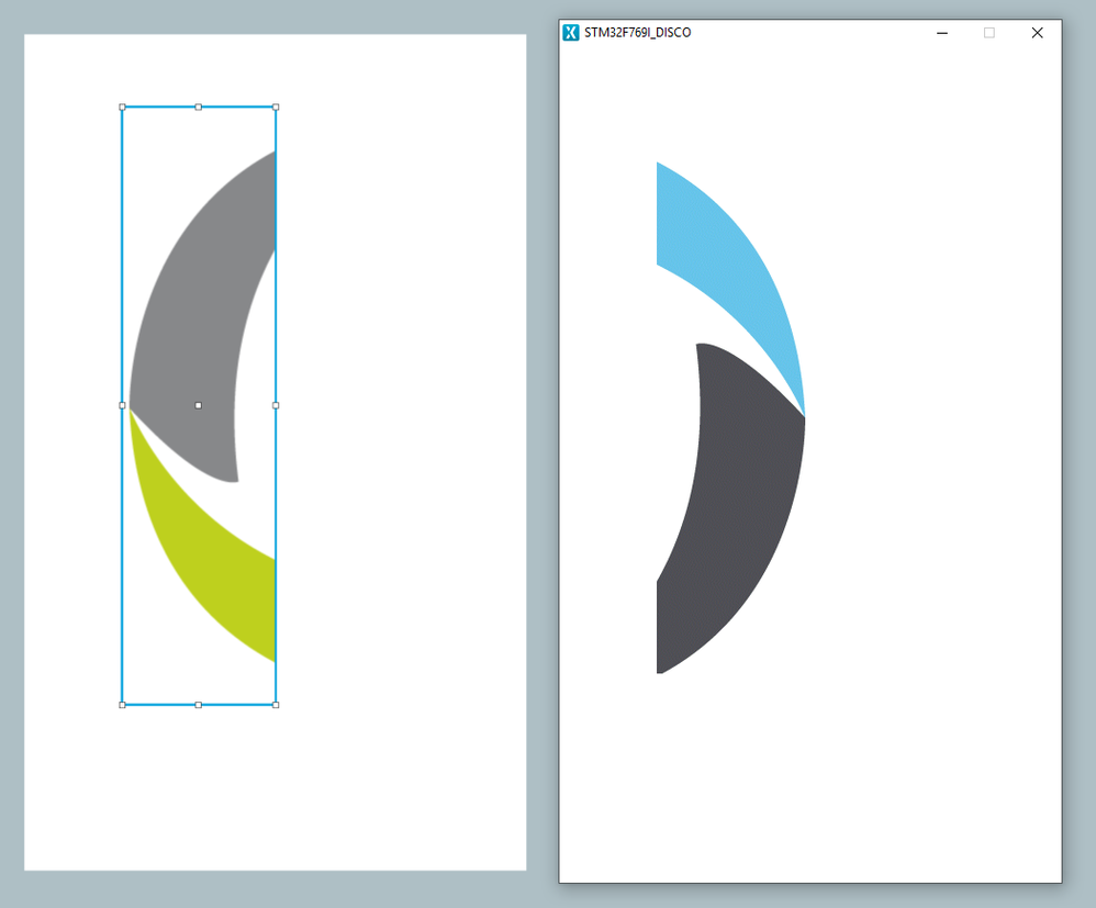

I didn't face it at first even when changing the width or height of the circle (which I tried as well previously) because I was still using a very wide scenario. When I tried setting a smaller zone I faced it. In my case i will make a first assumption that the widget considers that you are in the original display orientation (landscape, not portrait), which is why in my screenshot (on the left is the canvas in Designer and on the right is the simulation) the right side of my image used in the circle is displayed even though I set it to display the left side. Or something similar, anyway I was able to replicate the bug so this is good news in a way :grinning_face_with_sweat:
initial image:
Thank you for reporting this, took me more time than wanted to face it , but now I have created an internal ticket for the Designer team so that they can further investigate and fix this bug :thumbs_up:
