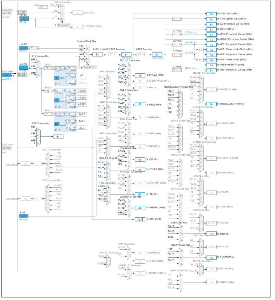

Question 4:
I have problems with CubeMX, to generate the correct timing. I have a working timing configuration set, done “by hand�?.
I would like to be able to generate it from CubeMX, so I can still continue use it to update the generated part of the project,
But I’m not able to set clock-timing, that generates a working set of settings.
I tried to identify which parameters I should modify, to receive the desired set of settings, but was not able to make this kind of “reverse work�?
Can you help me?
