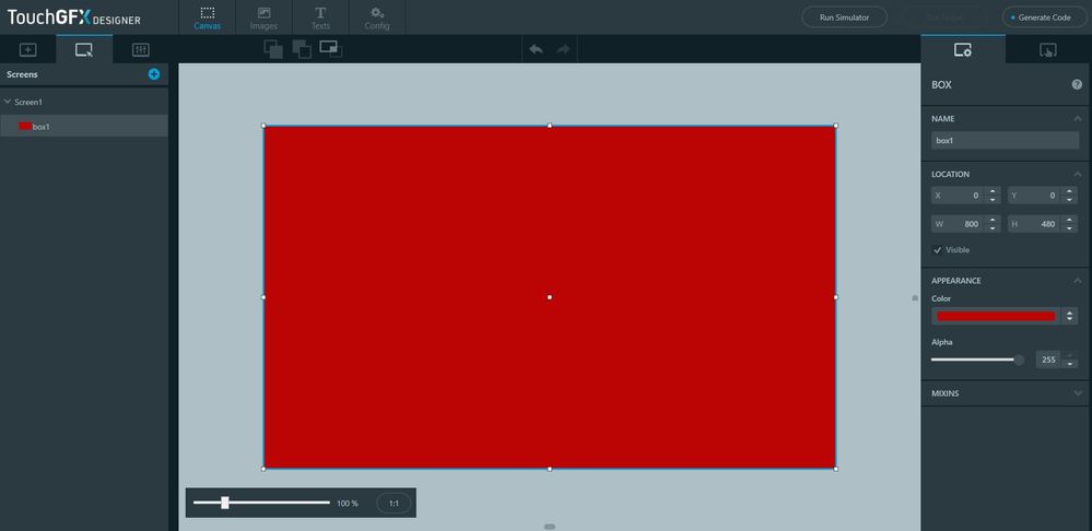

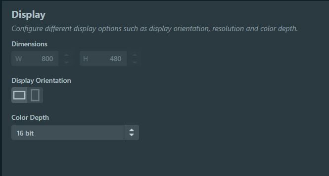

When imported, i used .part file to make the GUI but the screen size doesnt seem to fit my configs(configs was 480x272, the GUI designer recognised it as 800x480.) . Can these all be related with FMC QSPI adjustments? If not was my approach correct for custom board?

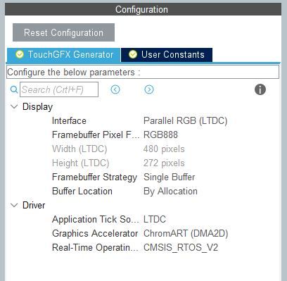

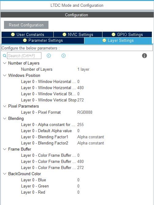

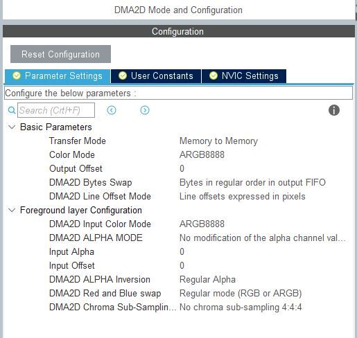

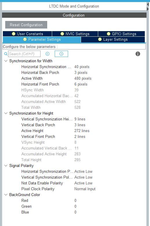

Thanks for the reply:thumbs_up:
So from cubemx i choose these options:
shouldnt these configurations generate a .part file for a screen size of 480x272

Yes, the part file should reflect these settings. Do they? Post it.

I can not change the Width and Height parameters on the TouchGFX also. And the color depth automatically set to 16 bit.
