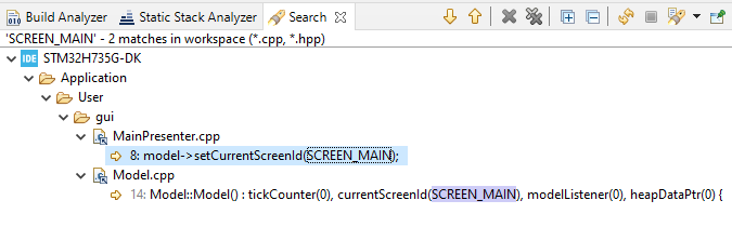

A global file search for the term SCREEN_MAIN
returns results only for the .cpp files linked in the gui folder, but not for ScreenIds.h:
This means that Eclipse's global search, one of the most powerful tools for browsing a project when one is not familiar with the project's organization (as one might do when studying the TouchGFX examples) is greatly reduced. Moreover, it means that global replacement of a specific string or term is made impossible, and must be done “by hand�? on individual .hpp files, once they are located by some means other than global search.
