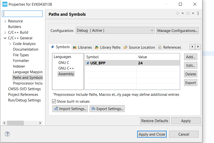

Hey figured out the solution.
Posting it here, in the hope it will help out someone in future.
Issue was with mismatch of USE_BPP settings between TouchGFX and STM32CubeIDE.
In TouchGFX its 24 and in STM32CubeIDE it was set to 16.
Changed the settings to 24 in STM32CubeIDE and voila it worked :)
