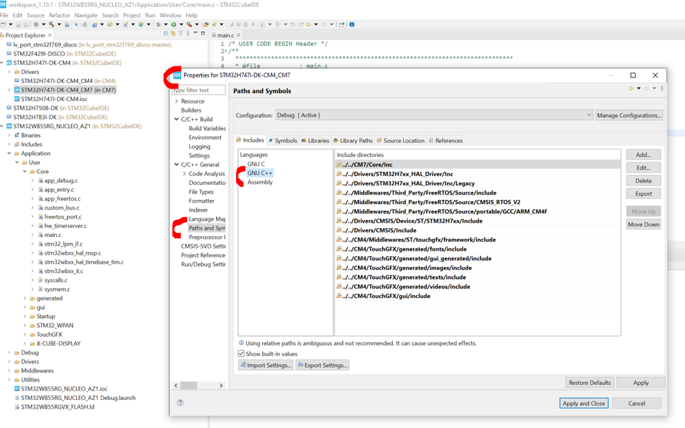

2023-01-12 7:05 PM
This seems to me like a path missing issue in STM32CubeIDE. Even if the files does exist and the include is correct in the code, STM32CubeIDE may not know how/where to look for it. So you need to go to the properties of your project (right click on the name of your project on the tree view on the left), and navigate to the path and symbols section. The screenshot is just to show you were to navigate, try to add to your project as a path maybe ../TouchGFX/generated/videos/include if it is not already included
The video_sample..._bin_start initialisation is in VideoDataBase.hpp in the generated/videos/include/videos folder so that is why i would first look there.
