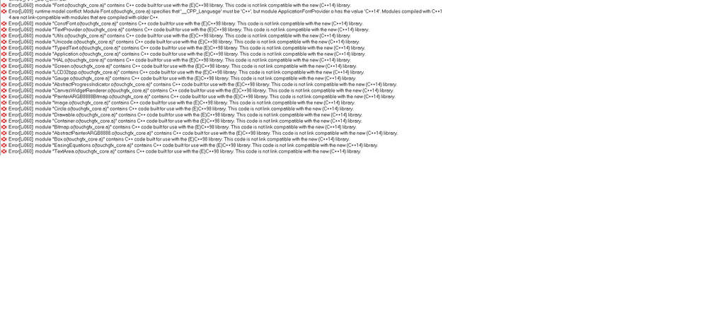

Hello @ysuh.1
STM32H7 package is compatible with V8.30.1 + ST-LINKV3 as mentioned in firmware release notes. IAR 9.X is not yet supported.
So, I think you have to switch the IAR version to 8.30.1 (and below).
