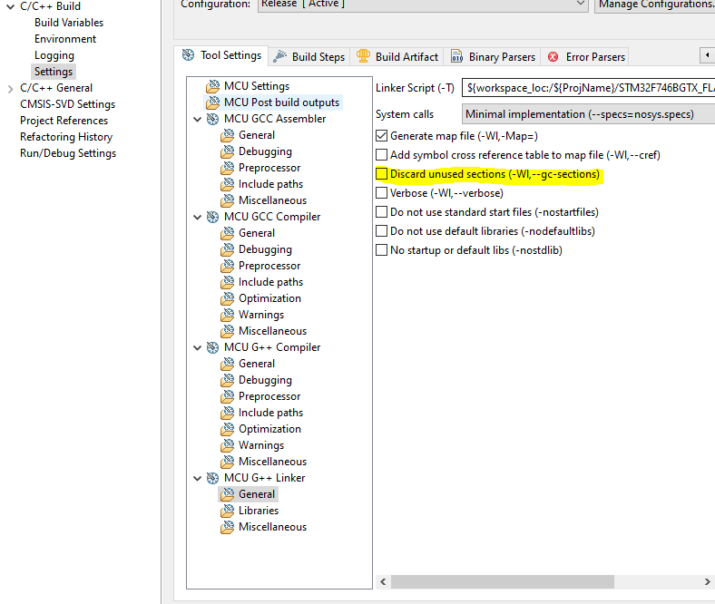

I have a microcontroller and QSPI flash. Everything works fine with TouchGFX. The pictures are stored in ExtFlashSection on the flash.
I need to store 3 large arrays for DAC. Tried adding to "STM32F746BGTX_FLASH.ld" except
ExtFlashSection :
*(ExtFlashSection ExtFlashSection.*)
*(.gnu.linkonce.r.*)
. = ALIGN(0x4);
} >QUADSPIsection like this
MusicFlashSection :
*(MusicFlashSection MusicFlashSection.*)
. = ALIGN(0x4);
} >QUADSPIalso added in "Middlewares\ST\touchgfx\framework\include\touchgfx\hal\Config.hpp"
#define LOCATION_MUSICFLASH_PRAGMA LOCATION_PRAGMA("MusicFlashSection")
#define LOCATION_MUSICFLASH_ATTRIBUTE LOCATION_ATTRIBUTE("MusicFlashSection")
Build Analyzer did not show a new section.
Then I found an example C:\Users\User\STM32Cube\Repository\STM32Cube_FW_F7_V1.8.0\Projects\STM32746G-Discovery\Applications\QSPI\QSPI_perfs
and copied in my "STM32F746BGTX_FLASH.ld"
.textqspi :
. = ALIGN(4);
_qspi_start = .; /* create a global symbol at qspi start */
*(.textqspi) /* .textqspi sections */
*(.textqspi*) /* .textqspi* sections */
. = ALIGN(4);
_qspi_end = .; /* define a global symbols at end of textqspi */
} >QSPI AT> FLASHand
.textqspi : { *(.textqspi) } >QSPIAdded my arrays similar to the example, but Build Analyzer still didn't show a new section.
Can someone please tell me what I've missed? The analogy just didn't work and I don't know where or how to look for a solution.
I programmed in CubeIDE.

2021-07-08 5:07 AM
