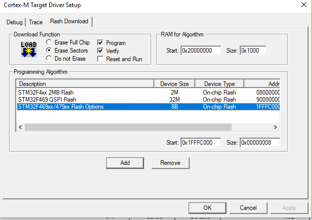

No, It is the project that is generated by TouchGFX. It creates several projects for different platforms. As I have described above I now have it working. The project it created had the wrong processor selected in the 'Options->Device'. Once I changed this it sort of worked. There was actually one more error. Although it now built I could not load it. This was because I had to add a programming algorithm (Highlighted below):
Once this was added it all worked....... so far!
I am surprised that I haven't seen this issue flagged somewhere else as I'm guessing this board is very popular and anyone using the generated Keil project would have the same issues I did. It is a simple fix but took me a while to figure out as I started down the wrong path.
