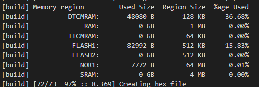

I have a custom board with STM32H7A3 using FMC, LLTC and other modules. I started to develop the firmware to change some images in a display. I made one project on TouchGFX with multiple images and fonts. I verify the BitmapDatabase.cpp and the all images files generated. For each image file generated for example:
LOCATION_PRAGMA("ExtFlashSection")
KEEP extern const unsigned char image_attention_all[] LOCATION_ATTRIBUTE("ExtFlashSection") = { // 223x265 RGB888 pixels.
0x0b, 0xba, 0xf7, 0x0b, 0xba, 0xf7, 0x0b, 0xba, 0xf7, 0x0b, 0xba, 0xf7,
...}In my application.ld file I put that configurations that I view on https://support.touchgfx.com/4.18/docs/development/scenarios/using-non-memory-mapped-flash
/* Specify the memory areas */
MEMORY
DTCMRAM (xrw) : ORIGIN = 0x20000000, LENGTH = 128K
RAM (xrw) : ORIGIN = 0x24000000, LENGTH = 1024K
ITCMRAM (xrw) : ORIGIN = 0x00000000, LENGTH = 64K
FLASH1 (rx) : ORIGIN = 0x8000000, LENGTH = 512K
FLASH2 (rx) : ORIGIN = 0x8100000, LENGTH = 512K
NOR1 (rx) : ORIGIN = 0x60000000, LENGTH = 64M /*External NOR Memory*/
SRAM (xrw) : ORIGIN = 0x62000000, LENGTH = 4M /*External SRAM Memory*/
}.ARM.attributes 0 : { *(.ARM.attributes) }
ExtFlashSection :
*(ExtFlashSection ExtFlashSection.*)
*(.gnu.linkonce.r.*)
. = ALIGN(0x4);
} >NOR1
FontFlashSection :
*(FontFlashSection FontFlashSection.*)
. = ALIGN(0x4);
} >NOR1
TextFlashSection :
*(TextFlashSection TextFlashSection.*)
. = ALIGN(0x4);

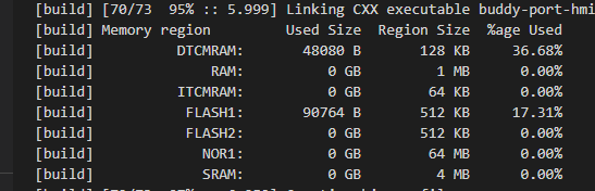

} >NOR1When I try to build the program I have section output from compiler:
What I'm doing wrong?
I only can write some program inside NOR1 when I change part of linker like:
/*Original data without write anything on NOR
/* Constant data goes into FLASH
.rodata :
. = ALIGN(4);
*(.rodata) /* .rodata sections (constants, strings, etc.)
*(.rodata*) /* .rodata* sections (constants, strings, etc.)
. = ALIGN(4);
} >FLASH1
/* Constant data goes into FLASH */
.rodata :
. = ALIGN(4);
*(.rodata) /* .rodata sections (constants, strings, etc.) */
*(.rodata*) /* .rodata* sections (constants, strings, etc.) */
. = ALIGN(4);
} >NOR1What am I doing wrong? How can I have a sure that I write all images files in External Flash?
Best regards,
Luis Cristovao

DEPENDS project_target_elf
COMMENT "Creating binary file"
VERBATIM
add_custom_target(project_target ALL
COMMAND arm-none-eabi-size project_target.elf
DEPENDS project_target.hex
DEPENDS project_target.bin
)And the Cmake file have:
set(CMAKE_SYSTEM_NAME Generic)
set(CMAKE_SYSTEM_PROCESSOR arm)
set(CMAKE_C_COMPILER "arm-none-eabi-gcc.exe")
set(CMAKE_C_FLAGS
"-mthumb -mcpu=cortex-m7 -mfloat-abi=hard -mfpu=fpv5-d16 -DSTM32H7A3xx -DSTM32H7A3xx -fmessage-length=0 -ffunction-sections"
set(CMAKE_CXX_FLAGS
set(CMAKE_EXE_LINKER_FLAGS
"-mthumb -mcpu=cortex-m7 -mfloat-abi=hard -mfpu=fpv5-d16 --specs=nosys.specs -specs=nano.specs -Wl,--print-memory-usage -Wl,--gc-sections -Wl,--unresolved-symbols=ignore-in-object-files"
set(CMAKE_C_FLAGS_DEBUG "-O0 -g3")
set(CMAKE_C_FLAGS_RELEASE "-O3 -g0")
set(CMAKE_FIND_ROOT_PATH_MODE_PROGRAM NEVER)
set(CMAKE_FIND_ROOT_PATH_MODE_LIBRARY ONLY)
set(CMAKE_FIND_ROOT_PATH_MODE_INCLUDE ONLY)
set(CMAKE_FIND_ROOT_PATH_MODE_PACKAGE ONLY)Thanks for your help.
2022-02-18 6:01 AM
here miss BitmapDatabase.cpp maybe more
i dont help you i preffer IDE or KEIL
2022-02-18 6:04 AM
I tried before with BitmapDatabase.cpp and the size of program don't change. Thanks for your help, I try to search more about it.
2022-02-18 6:41 AM
Thanks MM1, I solved my problem looking to the problem with other ideas.
The problem that I don't have any compiler to build .cpp files.
set(CMAKE_CXX_COMPILER "arm-none-eabi-g++.exe")Thanks a lot for your help :grinning_face:
