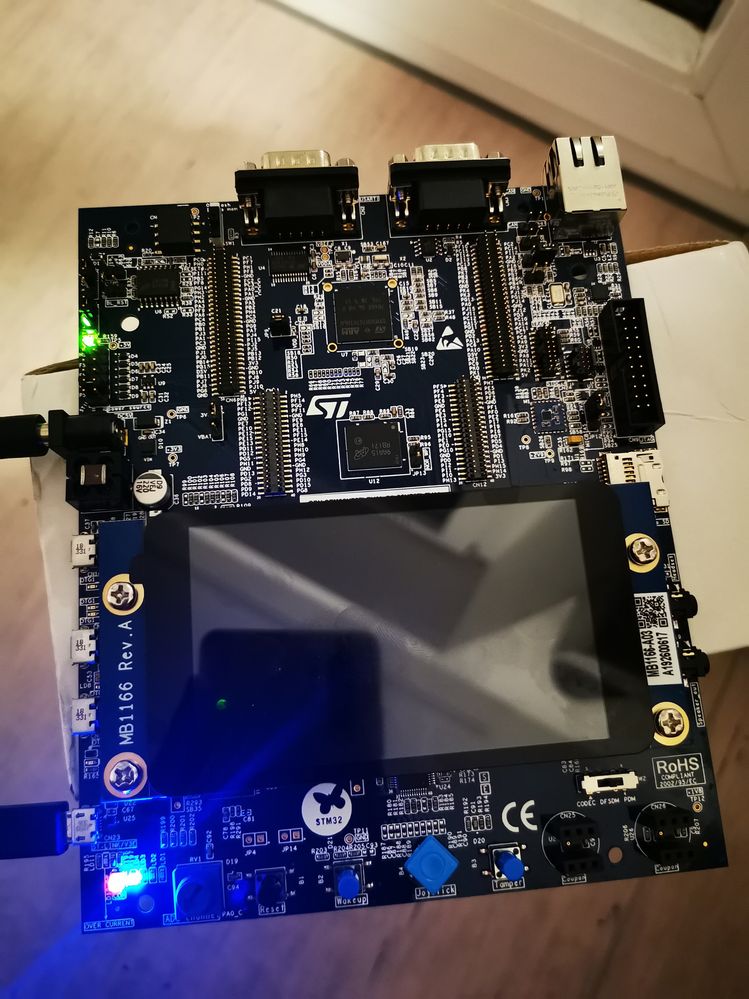

Hi, guys! So, I just got this board yesterday and I am having some trouble.
First, the LCD doesn't go on! I plug the power supply, LD9 goes on, plugging the micro A to the computer using the STLINK USB Port, I get red at the LD12 and that's all;

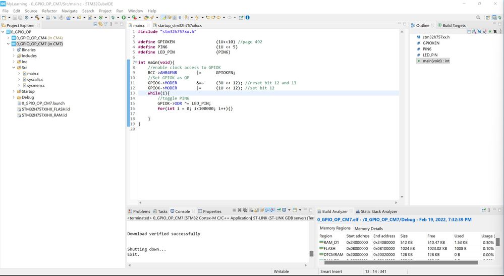

I was following a tutorial on Udemy on how to blink a LED, but although the LED goes on, it doesn't blink;
I even downloaded CubeProg and did those resets to see if 'd help, but it didn't;
Another thing is: How can I completely 'turn off' CM4, so that it doesn't appear on CubeIDE, doesn't generate errors and so on?
I tried to disable it using OB, but still. Every time I create an STM32 Project on the IDE it is there on the project tree, and I'd have to setting everything up for it as well.
The code I am trying is:
#include "stm32h757xx.h"
#define GPIOKEN (1U<<10) //page 492
#define PIN6 (1U << 5)
#define LED_PIN (PIN6)
int main(void){
//enable clock access to GPIOK
RCC->AHB4ENR |= GPIOKEN;
//Set GPIOK as OP
GPIOK->MODER &=~ (3U << 12); //reset bit 12 and 13
GPIOK->MODER |= (1U << 12); //set bit 12
while(1){
//toggle PIN6
GPIOK->ODR ^= LED_PIN;
for(int i = 0; i<100000; i++){}
PS: I went to the add paths and symbols and added STM32H757xx and CORE_CM7 to the symbols and (using the CubeH7 pack) I added the include folders from Drivers\Include and from Drivers\Device\ST\STM32H7xx\Include;
The code above compiles; I get the blue LED on, but it doesn't blink;
Can you guys help me?
Did I spoil my board by software/hard/core resetting it through the CubeProg?
Why does the LCD doesn't go on? Do I have to change jumpers? Does it need program code first?
How to work only with the CM7?

The LCD has a complex set of requirements and timings.
On the STM32 you have to set up a frame buffer, the LTDC with its clocks, the DSI to consume the pixel data and funnel it to the display.The display also likely needs a host of its configuration registers set correctly.
It's not that the board is ill-suited to register level programming, but rather that assuming that jumping into the middle of the ocean, clothed, is the best way to learn how to swim, or even a desirable one if you know how to swim.
The CubeH7 should have a handful of examples of driving the display under the Application and Example forks for the board. Use those as a simple starting point, understand how the HAL works, and the overall level of complexity, and then look at how you might approach a register level implementation, if that's even worth the time/effort involved, or if there are more productive and helpful skills you can learn with the board.

If optimize levels is setup in your project your for code is removed out and led toggle on high invisible speed...
Your idea for register coding with LCD is absurd.
In project create wizard you can select example project for your board...

The bit pattern is for PK5 other PK6
2022-02-19 6:15 PM
Yeah, during editing the code to paste here/try on the board I forgot to change the LEDs shift;
Believe me or not, I now got them blinking;
My code now looks like:

CliveOne, could you please help me with the LCD issue? Is the LCD broken or what sort of extra settings does it need?
I did nothing to/with it; the only coding running on the board is the LEDs one and I didn't change any of the pins/jumpers;

Absurd part is for example LCD with MIPI DSI® interface on your board need around 100 registers config for start working plus next regs for sdram ... You can do this , but your code will be ... but work maybe.
Good point is configure system with HAL and in custom code when required use registers...

2022-02-20 6:26 AM
STM32Cube_FW_H7_V1.9.1\Projects\STM32H747I-EVAL\Applications\STemWin\STemWin_HelloWorld
STM32Cube_FW_H7_V1.9.1\Projects\STM32H747I-EVAL\Examples\LCD_DSI\LCD_DSI_CmdMode_DoubleBuffer
STM32Cube_FW_H7_V1.9.1\Projects\STM32H747I-EVAL\Examples\LCD_DSI\LCD_DSI_VideoMode_SingleBuffer
STM32Cube_FW_H7_V1.9.1\Projects\STM32H747I-EVAL\Examples\DMA2D\DMA2D_RegToMemWithLCD

Thank you so much for your reply;
Yeah, since I am not a professional yet, I should get to know what the HAL does first, before trying to optimise anything; and maybe get a less complex board to learn learn how to do the register programming, for I find that amazing ahah; although I am a student and work, when not at the Uni, I don't have a PhD final commercial product to deliver YET, so I may have a bit more freedom/time to experiment, therefore, everything I learn on Registers can only be of help for my later work and job;
I will also try to run the examples and see if I get the display to turn on; I guess I can't get it on when I power the board because I, when full erasing/resetting it, may have erased the manufacturer configuration/boot code that turns it on; I don't know it that makes sense, but anyways...
Again, thank you very much for your inputs.
