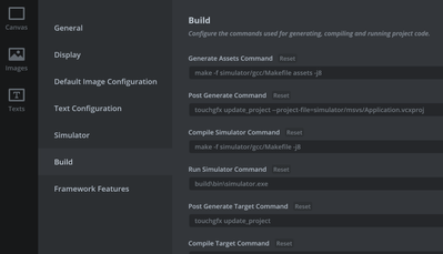

As i write problem is IDE not TFX. And rel source is in call post generate target line in TFX generator. Try correct this line in designer config ...
