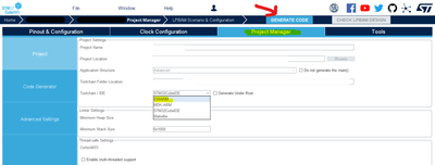

What you need to do is after step 4 :
4.1) Open the ioc file with STM32CubeMX - go to "project manager" menu and select EWARM toolchain - and press generate code
4.2) go to your project under TouchGFX Designer and press generate code
Then you can go to your step 5 :
5- Open your project under IAR
Let me know if that helps.

By default, our TBS already provide generated code for STM32CubeIDE toolchain.
2023-11-10 5:12 PM
Thank you so much for your helpful response on the ST forum! Your solution worked perfectly, and I really appreciate you taking the time to assist me. Thanks again!
