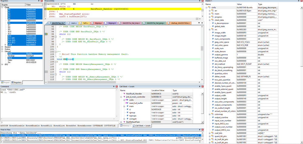

I build a project with STM32CubeMX and using LibJPEG to decode the JPEG file from SDCard.
And now I face a problem ,when it goes to the step 5 - start to decompress, it will stock in that function with no reason and the hardfault descripe like down below.

So you're going to need a more effective Hard Fault handler that can identify the faulting instructions/registers.
Likely you are overflowing an input or output buffer, or a malloc() is failing. If the code needs to allocate memory dynamically, make sure you actual have some heap space for it to use.

2019-10-23 8:30 AM
I mean have the routine provide some actionable data rather than spin in a while(1) loop with nothing identifying the fault. The debug view you have screen shot really doesn't clearly identify the failure point and the registers.
This needs some output via a USART or SWV, but illustrates what the hard fault routines should be doing for any real field analysis or debugging to occur.
Determine where the code actually faults, and look at the disassembly of the code there, and immediately preceding. Likely acting on a memory pointer, or call-back, which are invalid.
