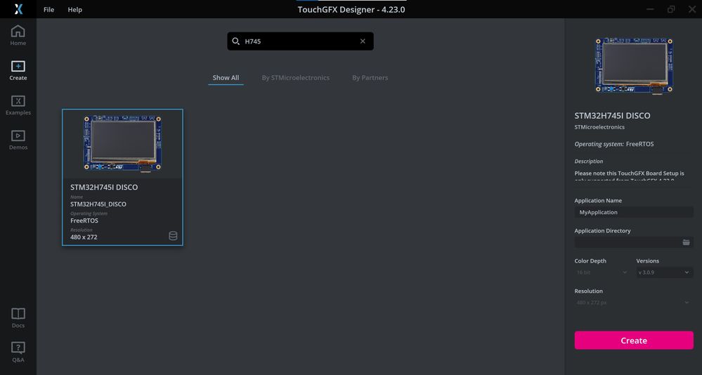

2023-12-21 5:11 AM
Hello again,
There is already a board setup ready for STM32H745I Discovery in the TouchGFX Designer that you can easily use to develop your application, and SDRAM and other required parts are already configured.STM32H745I Discovery
Is there any specific reason that you are not using this setup?
If you still want to use your own configuration, you can consider this setup as inspiration.
I hope this helps you

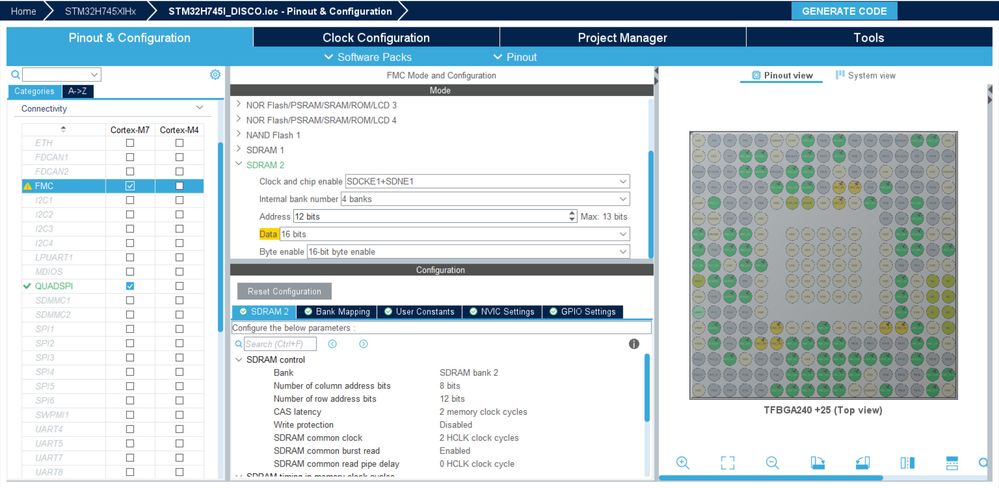

2023-12-27 4:30 AM - edited 2023-12-27 4:31 AM
I understand.
I've taken a look at the files you have attached and noticed that you are creating these files yourself. Unfortunately, I'm not an expert on SDRAMS, but I think it would be a better solution to configure the related settings through your STM32CubeMX project.
You can access those settings from Connectivity -> FMC -> SDRAM. SDRAM settings in CubeMX
Please check if this can help you resolving your issue.
Good luck
2024-01-02 3:47 AM
Hii @Mohammad MORADI ESFAHANIASL ,
I have configured from STM32CubeMX and initialized the pins from Connectivity -> FMC -> SDRAM.
And I also enabling the LTDC, but the screen is getting flickering when I enabled 24bpp in ltdc, and I am not getting any flickering issues when I enabled the 16bpp in ltdc and the external SDRAM.
What is the clock I need to configure for FMC with SDRAM?
Is my screen is getting flickering because of the SDRAM clock issues?
