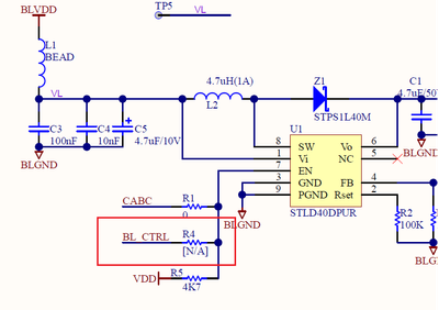

According to the LCD board schematic, it seems the back light control pin is not connected to the LCD back light controller input (EN):
You need to solder R4.

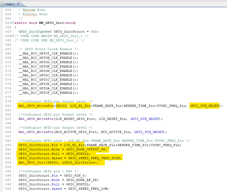

Hello @Louie88,
Yes, it is the right function:
HAL_GPIO_WritePin(GPIOJ, LCD_BL_Pin, GPIO_PIN_SET);
But try to configure the GPIO pin as bellow:

Thanks Dor_RH,
It is actually done in main.c MX_GPIO_Init() method:
I think mƎALLEm is right (see above post). The R4 is really not assembled in MB166 LCD Module (See the attached microscope image) so the BL_CTRL (PJ12) GPIO output does nothing with the backlight enable pin. It is always connected to CABC pin which is a pin of the CN2 connector (whatever it is).

Hi mƎALLEm,
Thanks for your valuable note, I think you are right. The R4 is really not assembled in MB166 LCD Module (See the attached microscope image) so the BL_CTRL (PJ12) GPIO output does nothing with the backlight enable pin. It is always connected to CABC pin which is a pin of the CN2 connector (whatever it is). The R5 pullup resistor is also omitted...
Now the question is may I shortcut the CABC signal (whatever it is) with BL_CTRL to make the backlight control work?
Thanks,
Louis
2025-02-24 12:04 AM - edited 2025-02-24 12:09 AM
Try to disconnect CABC by removing R1 +R5 and solder R4 to connect BL_CTRL.
