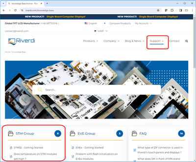

@NicoEFI wrote:on a riverdi RVT70HSSFWCA0 screen
Have you asked Riverdi that?
They would be the ones to provide examples targetted for their particular boards:
https://riverdi.com/knowledge-base
