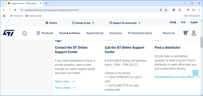

Also, it's a community forum - most participants are not ST employees.
If you want direct support from ST, see: https://www.st.com/content/st_com/en/support/support-home.html

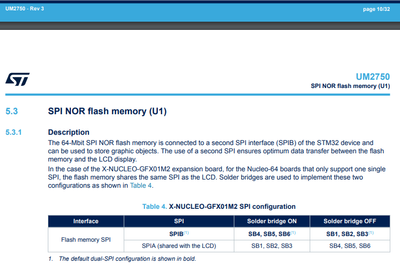

PS:
The SPI NOR Flash on the X-NUCLEO-GFX01M2 is documented in the User Guide - starting on page 11:

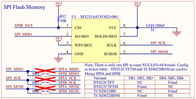

See also the schematics:
https://www.st.com/en/evaluation-tools/x-nucleo-gfx01m2.html#cad-resources
From there, you can find details of the memory chip:
