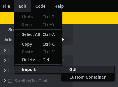

LouisB
Hello @FJB2069 ,
If you have a Tgfx project for your chip, you can import the UI from another one by clicking on Edit/Import/Gui.
BR,
Louis BOUDO
ST Software Engineer | TouchGFX
