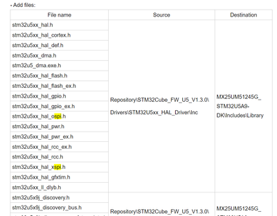

Hello @jr_engr_mbed ,
I think the answer is this other thread of yours is also the right answer to your last message here : https://community.st.com/t5/stm32-mcus-embedded-software/how-to-build-right-loader-for-fmc-norflash/td-p/718234
The main difference between FMC and SPI for external loader is that you need to do your initialization for FMC, not SPI and then you will get the files.
When he say "add files":
Add the FMC files that you will get.
Also, in his example, he uses a discovery board so he know what the memory is connected to.
If you also use a discovery board, you should check the hardware file available on the product's page.

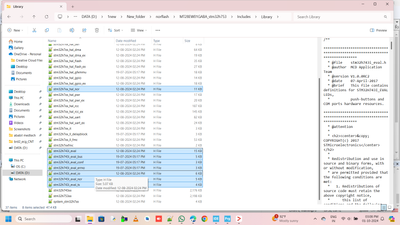

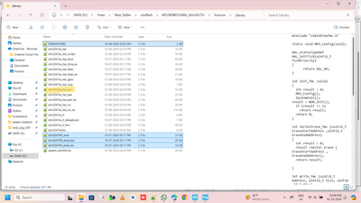

Thank you for providing the solution. I need to create a loader specifically for my custom board. I was able to initialize FMC_NOR and successfully read device codes, perform read/write operations, and toggle the LED as mentioned here.
After this,The next step is creating the loader. In the IAR Workbench, as you suggested, I added HAL_NOR instead of the SPI files and perviously used the H743-EVAL since the NOR flash is adapted from its design. So, from your reply to adding files section, should i avoid adding these files when generating the ST-LDR file, correct?
I attached main.c file which is able to read,write,and led blinks... so, where should i use main.c tested program in loader creation..?
Let me know if you'd like any further changes!
