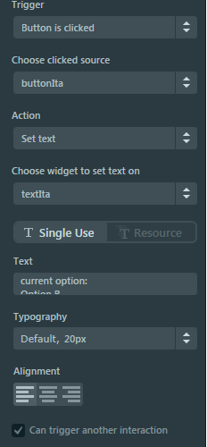

using touchGFX i set an interaction when a button is pressed to chage that text area, and i need it to become:
current option:
Option B

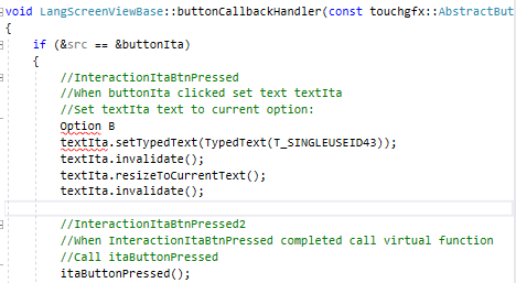

when i put those tho line in the text field in the Interaction options on touchGFX like showed
what TouchGFX generates on ScreenViewBase.cpp is this:
and OFC won't compile.
