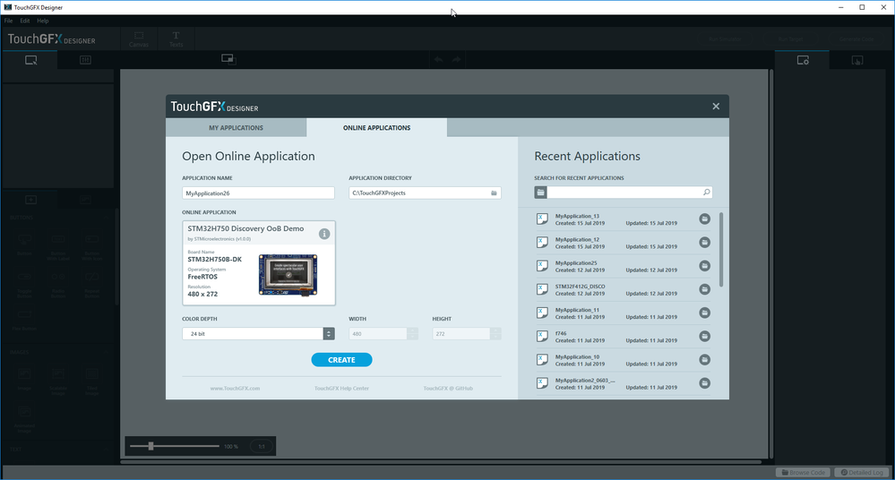

I have been looking for the source for this demo because I'd like to see how they did the video and have not been able to find it. Could you provide a link to where you found it?
2019-07-15 12:40 AM
Hi @scottSD
We do not have a weblink for the source code for the demo, instead you have to go through the TouchGFX Designer to create an application for the STM32H750 Discovery board.
This is how you do it:
After opening TouchGFX Designer, select the tab called "Online Applications"
Here you will find demo applications which are tied to a specific board, the application you are interested in is called "STM32H750 Discovery OoB Demo"
/Anders
2019-07-15 6:14 AM
Thankyou Anders.
Just what I was looking for!
