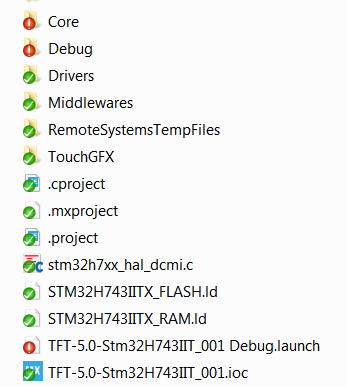

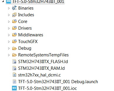

What I expected to see is a project file structure similar to one that is created when starting a project from an IOC file using CubeIDE. Here is an example of that style:
The Core and TouchGFX directories are there. Basically, the Project Explorer view is the similar what Windows Explorer shows:

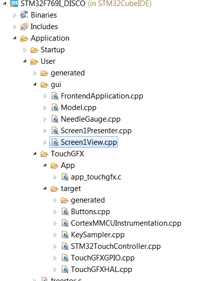

Now, when looking at the project started using the TouchGFX Designer, I do see that the TouchGFX gui files are located in Application / User / gui:
However, where are the hpp files (which are in the "include" directory in the file system)? The only way to view it is to manually open it or "drag and drop" Screen1View.hpp into CubeIDE.

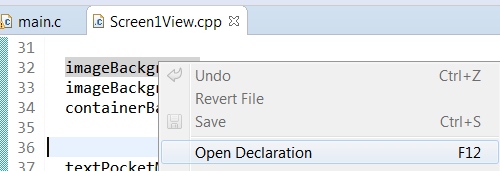

And....when I attempt to open the declaration of a variable in Screen1View.cpp, CubeIDE does not take me there:
Sorry if I am missing something here. I have been working with my project based on my own custom board and the project layout is different than one started from TouchGFX Designer. So I may not be doing something correctly.
