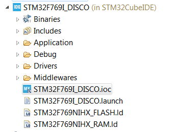

@Martin KJELDSEN
There is something strange when creating a project in TouchGFX Designer and then doing a "File->Open Projects from File System" in Stm32CubeIDE.
The Core directory and the TouchGFX directory are NOT included in the Project Explorer of Stm32CubeIDE:
Why is this?
Does this mean one must edit the Core files and the TouchGFX externally and not in this project?
I also notice that trying to Right Click > Go to Declaration on a variable does not take you to the declaration if that file is not part of the project.
What is the proper way to create/import/open a project in Stm32CubeIDE that was created in TouchGFX Designer?

2020-04-28 4:02 PM
By "TouchGFX" do you mean the generated code and user code from the designer? This is under "Application/User/TouchGFX", and the "Core" files are under "Application/User". I agree that this can be confusing if one is trying to map to the filestructure directly.
