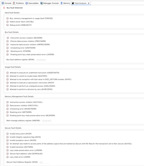

Hello @kicur ,
I tried the same, with same versions but don't reproduce the issue.
The TIM7 interrupts fires but does not generate any error.
You can check what exactly is causing the error using Fault Analyser window, and checking assembly instruction generating the fault. This should help understanding the root cause
Best regards
Jocelyn

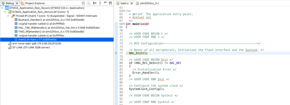

2026-02-25 10:55 AM
Hello @Jocelyn RICARD ,
Thank you for your feedback.
I wanted to double-check everything and go through the steps again, but I found something interesting: after reconnecting my board, the application runs without any problems. However, when I debug it with ST-Link, it crashes again like before.
To summarize:
MyApp with FreeRTOS — works when running on the board normally
MyApp with Secure Manager + FreeRTOS/TIM7 — works only when not debugging
MyApp with Secure Manager, without FreeRTOS and TIM7 — works even when debugging
So maybe this situation gives a hint about where the issue is? I also attach screen of the Fault Analyzer.
