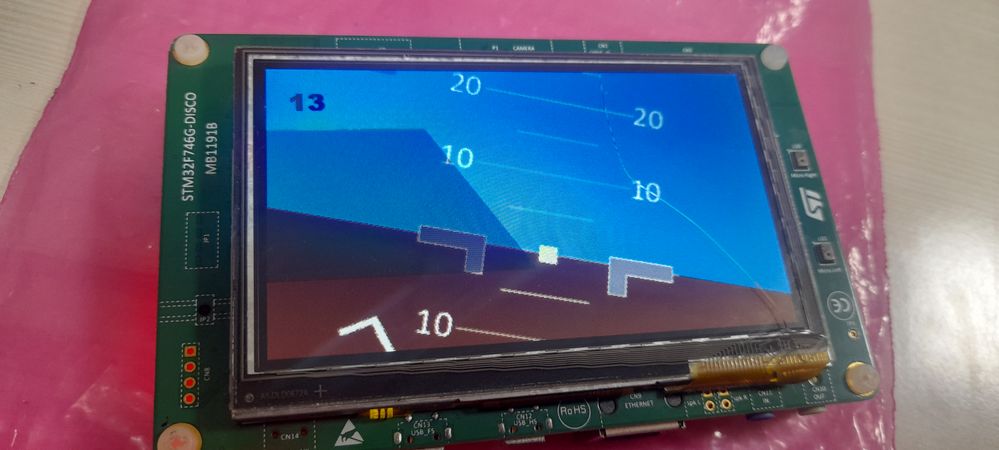

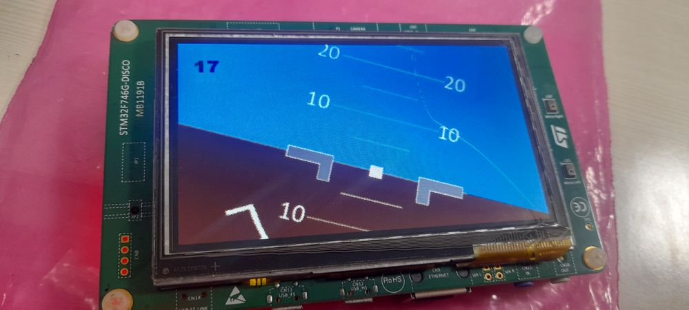

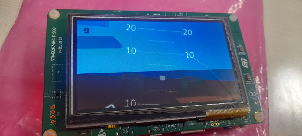

Hii,
I have changed the values repeatedly in foreground through TextArea, while the image is tilting in the background.
But it is worked fine in Simulator, but I am getting some disturbance image while I am trying to display in the STM32F746G Discovery Board. I am unable to load the simulated image in the board when the foreground values are changing and the image is moving in the background simultaneously...

Could you share some video or screenshots of the problem ?

These are the images which I got the disturbed screen in my STM32F746G Discovery Board...May I know why I am getting these type of issues?
After the background image is stop running, the foreground image is not getting disturbed.

Which kind of Framebuffer strategy are you using ?
Single, Double or Partial ?
2023-08-23 9:43 PM
Hii,
I am using Single Framebuffer.
