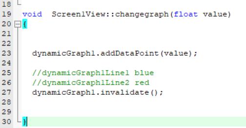

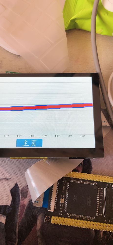

Hi,i want to make a oscilloscope to show two data curve.I found the dynamicgraph can add many lines with different color.BUT i can only use the "addDataPoint" fuction to add one data at one time.So I set the two lines the different LineWidth.
Just like this.
These two lines show the same data,becuse the addDataPoint function can just input one variate.

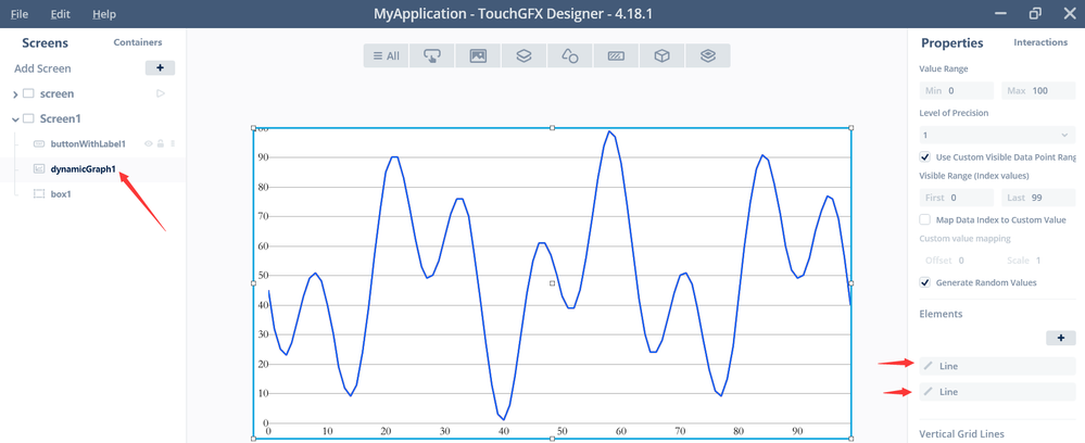

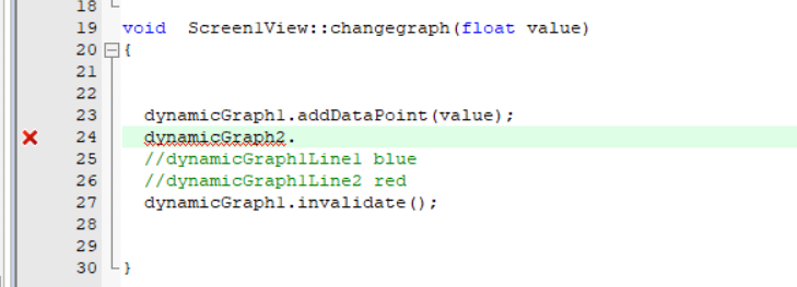

I just create one dynamicgraph widget,it will be error.
I want to show these two lines which in the right just in dynamicgraph1.:persevering_face:
2022-02-22 1:52 AM
Check your Screen1ViewBase.hpp header for correct names. They should be of type touchgfx::GraphScroll<NNN> like:
touchgfx::GraphScroll<100> dynamicGraph1;
touchgfx::GraphScroll<100> graph2;
touchgfx::GraphScroll<100> graph3;Then use those classes.

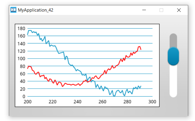

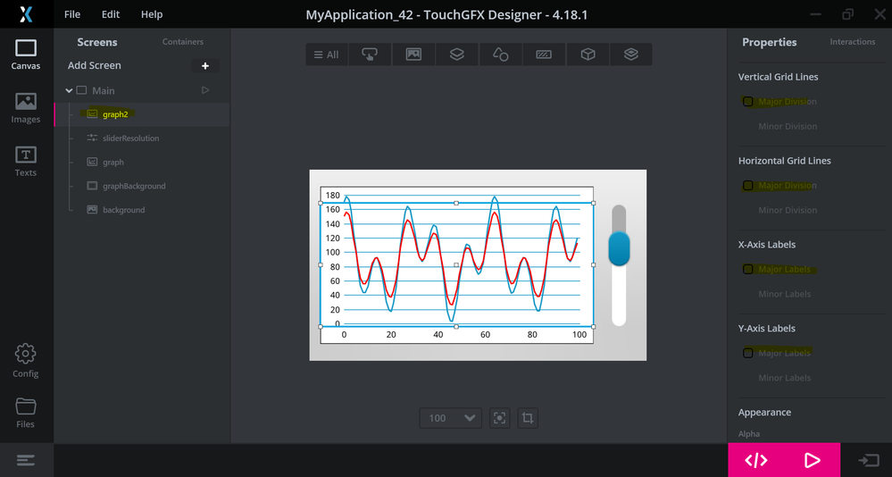

I wouldn't recommend you to use 2 lines elements for a single dynamic graph widget. The easiest way would be to use 2 different widgets like this :
Be careful to uncheck the boxes on "Vertical Grid Lines", "Horizontal Grid Lines", "X-Axis Labels" and "Y-Axis Labels". That way, you will have 2 independent graph lines in the same view.
I attached a basic project if you need an example.
/Osman
2022-02-22 3:48 AM
Thank you all.I create two dynamic graph and align them.The program ran successfully now.
