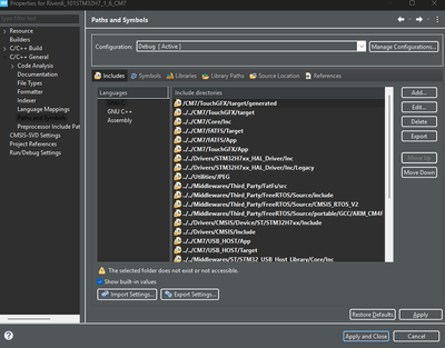

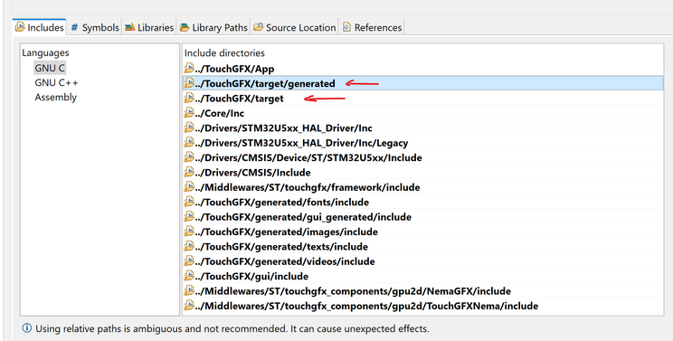

Hello @TahaBugraa and @JamshaidUsman
I'm really sorry for the late response @TahaBugraa
Could you please check if the headers are correctly added to the Includes under Paths and Symbols in your project properties -> C/C++ General?
These two should be available.
2024-08-08 4:34 AM
I just include the project path to the MCU GCC compiler, and its working fine.
Thanks for your help.
