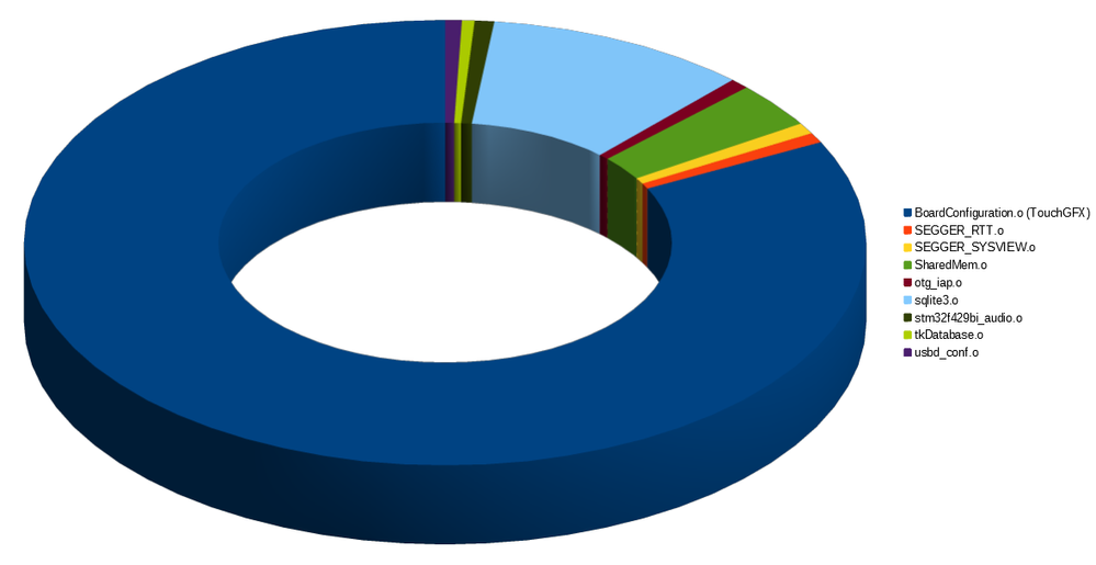

I've encountered the problem with not enough space on the internal SRAM many times when I've tried to add more view or container in the TouchGFX application.
Eventually, I've found that high memory usage has occurred from the 'static FrontendHeap' singleton object when I've analyzed the memory map file.
How can I move the 'FrontendHeap' to external memory such as SDRAM?
My hardware board specification:
Please find the pie chart (attachment image) for more detail about memory usages.

You can define your linker scripts (whatever you're using) to place specific .o files (like FrontEndHeap.o) in specific memory regions.
