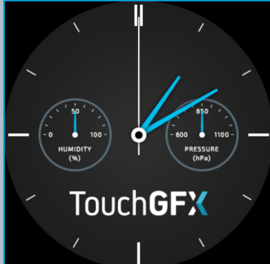

2021-06-24 2:58 AM
The project name is TouchGfx Watch. I use stm32h7 series. I wonder how the pressure line moves like this.

Hello limit_SKY,
If you look at the code, you'll see that the pressure needle is an Animation Texture Mapper and every x seconds, we setup an animation for the needle. Here is the code related to the pressure needle :
pressureEntropi = (((seconds + minutes + hours) * (seconds + minutes + hours)) % 180) / 360.0f * 2 * PI - PI / 2;
pressure.setupAnimation(AnimationTextureMapper::Z_ROTATION, pressureEntropi, 250, 0, EasingEquations::cubicEaseInOut);
pressure.startAnimation();And the prototype of setupAnimation() is as follows :

virtual void setupAnimation(AnimationParameter parameter, float endValue, uint16_t duration, uint16_t delay, EasingEquation progressionEquation = &EasingEquations::linearEaseNone);You can find all this information yourself by going through the code and looking at AnimationTextureMapper.hpp/.cpp
/Alexandre
