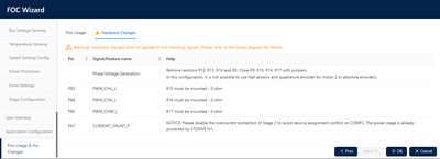

The M2 driving topology has been modified for your use case. As mentioned in the workbench tool, hardware modifications must be implemented.
Using your STWB6, with the default driving topology (U, V, W, shared enable) and without hardware board modification, the M2 motor spins.

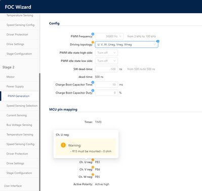

2025-11-04 2:16 AM
Hello @GMA ,
In this case, I am using the M1 modified driving topology, as shown in the attached file. Should I modify that file as well, or is it already suitable for M1?

2025-11-12 12:20 AM
Hello @Chandana_Arava,
Your last picture displays the M2 settings, not the M1 settings.
In your Ready_to_sky_920KV_Dual_V2.stwb6 file, you are using the default configuration for M1, while the M2 configuration has been modified. For M2, hardware modifications must be performed as mentioned in:
