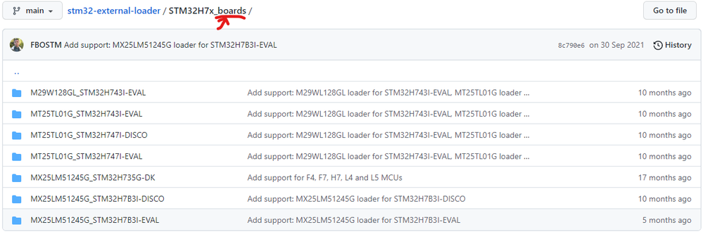

Hello @molecule.192g I replaced with new FLASH. But this problem continues. FLASH came from Macronicx sample
2022-03-08 6:00 AM
Hi @Patrickhiapello
These files for board not for STM32H7B3IIT6. Wouldn't it cause the same situation?
2022-03-08 7:09 AM
The loaders are highly implementation specific, both MCU, pinning, and memory device. The H74x / H75x devices use QSPI, not OSPI, and the peripherals and pin configuration are different.
You'd need to look at the BSP and Schematics for these other boards to see what pins they use, and how these differ from your design.
You've not listed your pin utilization. These get to the be the "details" that are important.
You get to review the data sheets and function for the parts you have chosen.
You can't debug this with top-level error reporting logs from the programmer, it is far too vague and non-specific.
You CAN debug the underlying BSP code outside of the programmer, and fully validate that.
You CAN build a harness to test/stress loader code
You CAN output debug/diagnostic information from your own loader via USART to understand what's happening internally. You can add instrumentation to understand specific flow, and device responses.
You CAN'T single-step or breakpoint debug the loader in the programmer. But you can get registers and other details with Verbose Level of 3.

You post " These files for board not for STM32H7B3IIT6."
Okay.
You have to see the more simular to your application, take the example code and modify for your application to have extenal loader
okay?
2022-03-09 3:53 AM
Hi @Patrickhiapello Thank you for support. I am working on external loader for my board. The reason for this problem my board pins different of STM32H7B3-DK has pins.
