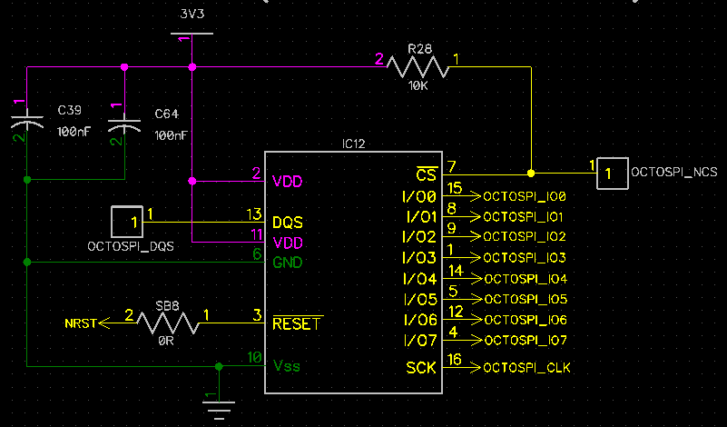

Schematic

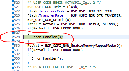

BSP_OSPI_NOR_Init_t Flash;
Flash.InterfaceMode = BSP_OSPI_NOR_OPI_MODE;
Flash.TransferRate = BSP_OSPI_NOR_DTR_TRANSFER;
BSP_OSPI_NOR_DeInit(0);
int32_t RetVal = BSP_OSPI_NOR_Init(0, &Flash);
if(RetVal != BSP_ERROR_NONE)
Error_Handler();
RetVal = BSP_OSPI_NOR_EnableMemoryMappedMode(0);
Error_Handler();
/* USER CODE END OCTOSPI1_Init 2 */
}I am trying to activate octospi as custom board design, but the program gives an error. The program gets an error at the following place? What do you think could be the reason?

Hello @ChahinezC I tryed in STM32H7B3I-DK develepment board. It worked. But I use custom board. When I tryed in custom board, this problem occured. I reproduce custom board but this problem continues
2022-03-06 10:03 PM
Hello @Osman SOYKURT This fonction returned -5 value. RetVal = -5
int32_t RetVal = BSP_OSPI_NOR_Init(0, &Flash);and BSP_ERROR_NONE value is 0. This function must return 0 value. So program goes Error_Handler()'s function
2022-03-06 10:07 PM
Hello @Community member BSP_OSP_NOR_Init()'s function returned -5 value. So This function must returned 0 value because
#define BSP_ERROR_NONE 0

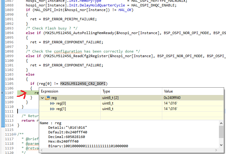

2022-03-06 10:36 PM
This problem occurs below in stm32h7b3i_discovery_ospi.c source file
#define BSP_ERROR_COMPONENT_FAILURE -5int32_t BSP_OSPI_NOR_Init(uint32_t Instance, BSP_OSPI_NOR_Init_t *Init)
int32_t ret = BSP_ERROR_NONE;
BSP_OSPI_NOR_Info_t pInfo;
MX_OSPI_Config ospi_config;
/* Check if the instance is supported */
if(Instance >= OSPI_NOR_INSTANCES_NUMBER)
ret = BSP_ERROR_WRONG_PARAM;
else
/* Check if the instance is already initialized */
if (Ospi_Nor_Ctx[Instance].IsInitialized == OSPI_ACCESS_NONE)
#if (USE_HAL_OSPI_REGISTER_CALLBACKS == 0)
/* Msp OSPI initialization */
OSPI_NOR_MspInit(&hospi_nor[Instance]);
#else
/* Register the OSPI MSP Callbacks */
if(Ospi_Nor_Ctx[Instance].IsMspCallbacksValid == 0UL)
if(BSP_OSPI_NOR_RegisterDefaultMspCallbacks(Instance) != BSP_ERROR_NONE)
ret = BSP_ERROR_PERIPH_FAILURE;
if(ret == BSP_ERROR_NONE)
#endif /* USE_HAL_OSPI_REGISTER_CALLBACKS */
/* Get Flash informations of one memory */
(void)MX25LM51245G_GetFlashInfo(&pInfo);
/* Fill config structure */
ospi_config.ClockPrescaler = 3U;
ospi_config.MemorySize = (uint32_t)POSITION_VAL((uint32_t)pInfo.FlashSize);
ospi_config.SampleShifting = HAL_OSPI_SAMPLE_SHIFTING_NONE;
ospi_config.TransferRate = (uint32_t)Init->TransferRate;
/* STM32 OSPI interface initialization */
if (MX_OSPI_NOR_Init(&hospi_nor[Instance], &ospi_config) != HAL_OK)
/* OSPI memory reset */
else if (OSPI_NOR_ResetMemory(Instance) != BSP_ERROR_NONE)
ret = BSP_ERROR_COMPONENT_FAILURE;
/* Check if memory is ready */
else if (MX25LM51245G_AutoPollingMemReady(&hospi_nor[Instance], Ospi_Nor_Ctx[Instance].InterfaceMode, Ospi_Nor_Ctx[Instance].TransferRate) != MX25LM51245G_OK)
else
/* Configure the memory */
if (BSP_OSPI_NOR_ConfigFlash(Instance, Init->InterfaceMode, Init->TransferRate) != BSP_ERROR_NONE)
#if (USE_HAL_OSPI_REGISTER_CALLBACKS == 1)
#endif
/* Return BSP status */
return ret;
* @brief This function enables the octal DTR mode of the memory.
* @param Instance OSPI instance
* @retval BSP status
static int32_t OSPI_NOR_EnterDOPIMode(uint32_t Instance)
uint8_t reg[2];
/* Enable write operations */
if (MX25LM51245G_WriteEnable(&hospi_nor[Instance], Ospi_Nor_Ctx[Instance].InterfaceMode, Ospi_Nor_Ctx[Instance].TransferRate) != MX25LM51245G_OK)
/* Write Configuration register 2 (with new dummy cycles) */
else if (MX25LM51245G_WriteCfg2Register(&hospi_nor[Instance], Ospi_Nor_Ctx[Instance].InterfaceMode, Ospi_Nor_Ctx[Instance].TransferRate, MX25LM51245G_CR2_REG3_ADDR, MX25LM51245G_CR2_DC_6_CYCLES) != MX25LM51245G_OK)
else if (MX25LM51245G_WriteEnable(&hospi_nor[Instance], Ospi_Nor_Ctx[Instance].InterfaceMode, Ospi_Nor_Ctx[Instance].TransferRate) != MX25LM51245G_OK)
/* Write Configuration register 2 (with Octal I/O SPI protocol) */
else if (MX25LM51245G_WriteCfg2Register(&hospi_nor[Instance], Ospi_Nor_Ctx[Instance].InterfaceMode, Ospi_Nor_Ctx[Instance].TransferRate, MX25LM51245G_CR2_REG1_ADDR, MX25LM51245G_CR2_DOPI) != MX25LM51245G_OK)
else
/* Wait that the configuration is effective and check that memory is ready */
HAL_Delay(MX25LM51245G_WRITE_REG_MAX_TIME);
/* Reconfigure the memory type of the peripheral */
hospi_nor[Instance].Init.MemoryType = HAL_OSPI_MEMTYPE_MACRONIX;
hospi_nor[Instance].Init.DelayHoldQuarterCycle = HAL_OSPI_DHQC_ENABLE;
if (HAL_OSPI_Init(&hospi_nor[Instance]) != HAL_OK)
/* Check Flash busy ? */
else if (MX25LM51245G_AutoPollingMemReady(&hospi_nor[Instance], BSP_OSPI_NOR_OPI_MODE, BSP_OSPI_NOR_DTR_TRANSFER) != MX25LM51245G_OK)
/* Check the configuration has been correctly done */
else if (MX25LM51245G_ReadCfg2Register(&hospi_nor[Instance], BSP_OSPI_NOR_OPI_MODE, BSP_OSPI_NOR_DTR_TRANSFER, MX25LM51245G_CR2_REG1_ADDR, reg) != MX25LM51245G_OK)
else
if (reg[0] != MX25LM51245G_CR2_DOPI)
return ret;
