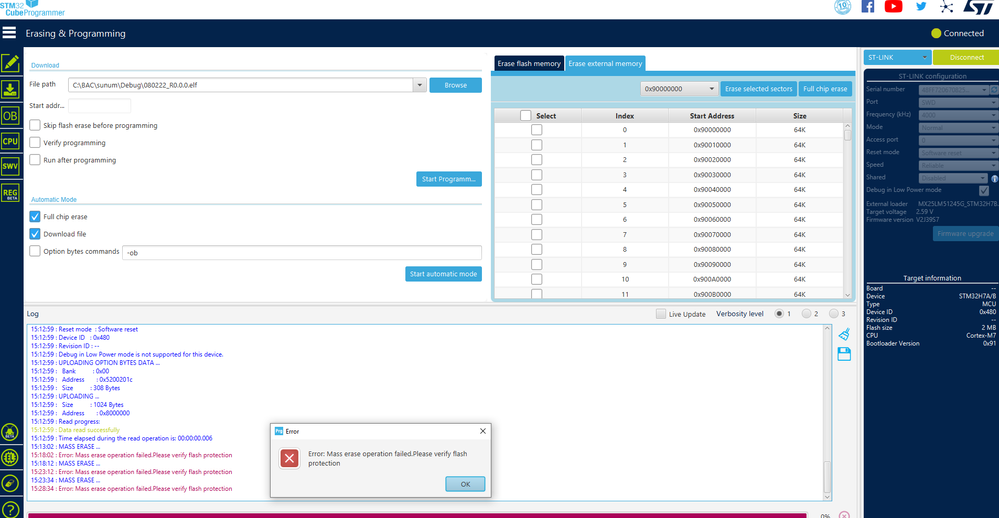

Hi Everyone,
I've made progress. But I am getting an error while uploading. What do you think could be the reason?

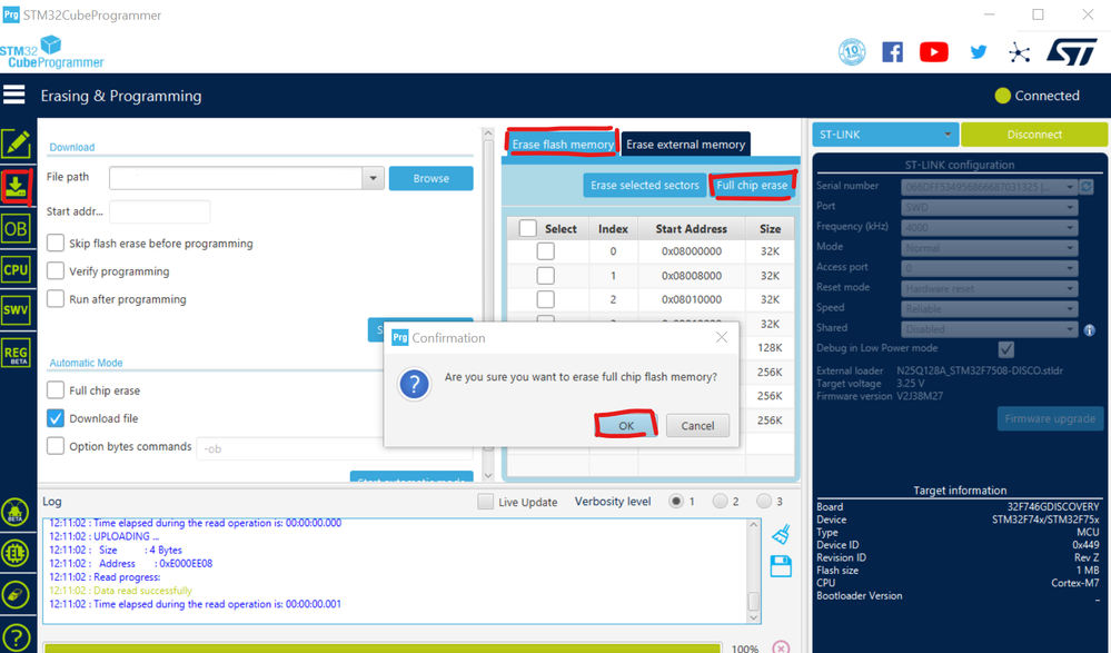

Hello Freedom_Neo,
We have a software called STM32CubeProgrammer that can help you erasing your memory. You can try to install it and then follow this steps :
1- Connect your board to your PC and click on "Connect" button (top right)
2- Click on the 2nd button on the left panel (with the arrow) and click on "Erase flash memory" and "Full chip erase".
3) If you want to erase your external memory, you can do the same with "Erase external memory"
You can also try to remove your breakpoints as it says there is a error with them.
/Osman

Hi @Osman SOYKURT
I did 1. and 2. steps. But The failure accurs 3. step. The deletion process takes 4-5 minutes, but at the end it gives an error as follows.
Dont have any breakpoint anywhere

2022-03-07 5:03 AM
Failing same way as your code, initializing chip prior to erase. Try to understand why read-back or commands fail in your implementation.
Check chip defaults written into non-volatile related to widths and pin usage. Read datasheet for part in relationship to the commands, and reporting, that is failing.
Set Verbose level to 3 for additional details/information from the tool.
