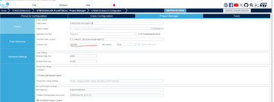

3. Using CubeMX to load project STM32U5A9J-DK-FreeRTOS.ioc(generated by TouchGFX Designer in step 2) and set IDE as EWARM, then click 'GENERATE CODE' to generate IAR project.

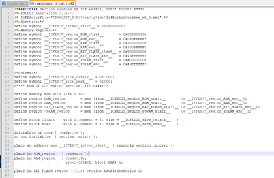

6. icf file:
The question is: what step shall I take to download image into external memory?

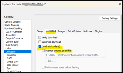

Do not forget to check Use flash loaders in debug options. And have a correct 'board file'.
